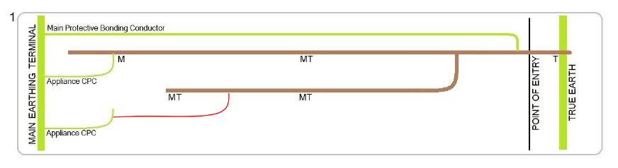

But I would like to understand what the difference is between (a) bonding the radiator pipe in my bathroom to the earth in my circuit (which I was told to have done some 15-20 years ago), and (b) bonding the water and gas pipes where they enter my flat (in the kitchen) to another earth point in the circuit (which apparently is not acceptable). I fail to see where you have answered this question. You say that the former was "supplementary" and the latter has to be "main" but I don't see what the difference is.
That is a fair question.
The answer really is a matter of size of bonding conductors and location of connections.
The Main Bonding conductor (usually) has to be 10mm² - this is in case it has to carry a high current because of the loss of the neutral conductor in a fault - and run to the Main Earthing Terminal.
It would actually make no difference where the MB conductor was connected to the pipe but it must be connected at the point of entry - because that is the point where any external potential enters the premises and more importantly to ensure that that point is never disconnected from the MET by alterations to the pipework within the premises - by the insertion of a length of plastic pipe for example.
So, you see your Supplementary Bonding in the bathroom - reducing potential difference between pipe and appliance/accessory - is not sufficient to satisfy these requirements.
Your SB is represented by the red line in this diagram:

OK, so the electric circuits in my flat use thinner cables than are used for main bonding and those thinner cables are not adequate for bonding. The supplementary bonding in my bathroom used that and it wasn't ideal, but it was better than nothing in the absence of RCDs and thicker cable to bond metal items in the bathroom.
My metal pipes at entry should be bonded with the thicker cable and it's no use attaching this to the earth cables in my kitchen as they will be too thin. So the bonding needs to go all the way to the point where the main electricity cable enters my flat.
Is it rather serious that my flat has seemingly had no main bonding for 30 years plus?
The main bonding cables(s) must go to the Main Earthing Terminal ("MET") of your electrical installation, which is usually in the vicinity of (sometimes inside) your Consumer Unit - which, in turn, will usually be close to the point of entry of electricity into the flat.
