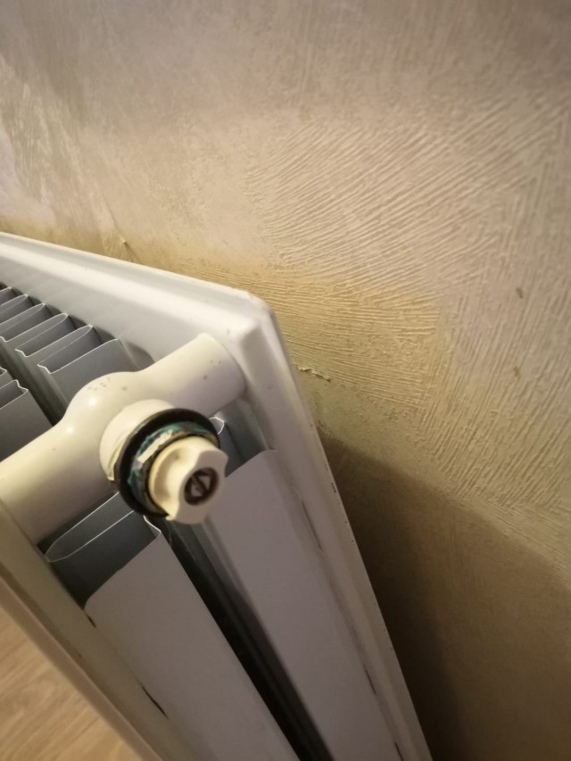

    Hi there,
    I just moved into my new property and I have realised how different the heating system seems to be compared to what I am familiar with.
    So, previously I had heaters 'dials' on every single one of them, where I could put them on and off to different temperatures. Now however it seems to be controlled by a thermostat and only some of the heaters have the dial thing on them (and for some reason, on these heaters is on the top, not at the bottom. I will upload pictures at the bottom because I know I am not that great at explanations, sorry).
    My main problem is, I need just one or 2 rooms to be good temperature at all times, the rest such as the hallways, frontroom, kitchen and stuff it's not really needed, yet now with this thermostat system if I put the temperature up to get the rooms toastie, I will make the whole house warm and consume a lot of unneeded gas.
    I am not a DIY person at all but I would like to hear what options I have before calling someone please? Is there a way to install those dials to the heaters that don't have it or any other way to make sure that the bedrooms are of a certain temperature and the rest of the house is not?
    Any help would be highly appreciated, thank you for reading this.

    please show us your timer/programmer and your wall thermostat, if any
    the dial on the radiator knob is a thermostatic radiator valve. It turns the radiator down, then off, when the room reaches the pre-set temperature.
    If the room is colder than the setting, the radiator will be on.
    Turning the setting up does not make the room heat any faster.
    I see one of yours is set to 6. This is too hot. Try it on 3 or 4. Close the room door or the heat will escape from that room.
    Rooms that you do not want heated can be turned to 1 or 2. The radiator will only come on if the room gets quite chilly.
    The radiator that has no TRV is probably in the room with the wall stat. This is correct. Do not turn it off.

    the little plastic knob on the top corner of your rad is to bleed gas out, if it gets any. You will know because the bottom of the radiator will be hot and the top cold. It does not turn the rad off.
    Your rads without TRVs will probably mostly have a valve at one end with a knob that you can use to turn them off.
    The "dial" is a TRV or Thermostatic Radiator Valve.
    As @JohnD has said, this is a bleed vent, which allows the trapped air/hydrogen out and replaced with water. Also as stated, yes the hallway rad can stay the same, as in no TRVs. If you want TRVs to all other rads, you can’t just stick dials on them, system needs to be partially drained and whole new valves fitted. If you don’t like the look of the one in the very first pic (trv at the top) then change this at the same time.
    However as @Madrab asked, is this rented?
    • Thanks Thanks x 1

    By the looks of it they are both lockshields with blank caps
