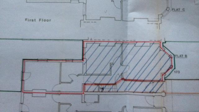

Plan is in my picture album. The diagonal shading is the ground floor and as you can see, the basement extends to the house's front doorstep at one end, and as far back as the centre of the hallway in the opposite direction.
Who do we call? I'm really at a loss of who to ask for a quote and what can realistically be done.
Little unclear as to your drawing, I am assuming the shaded area is the area of the basement below the ground floor!!

Thanks for your reply. Sorry that the plan is not very clear.
The basement is the shaded area on the plan, but doesnt eextens as wide across the property. It finishes in line with the doors you see in the middle. It's accessed by an open staircase from our hallway.

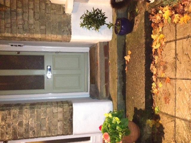

The rooms directly above the basement are the hallway and bedroom and the house is terraced. Therefore the only external wall that it meets (that's not a party wall) is at the front of the house. When approaching te house from the outside, you can see an air brick under the doorstep that has been filled in. Presume this was because of tanking?

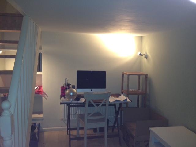

The photograph of the basement, were is the external wall in relation to the desk.?

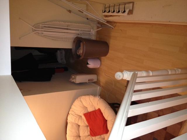

Thanks Russell. I was travelling before so excuse any typos.

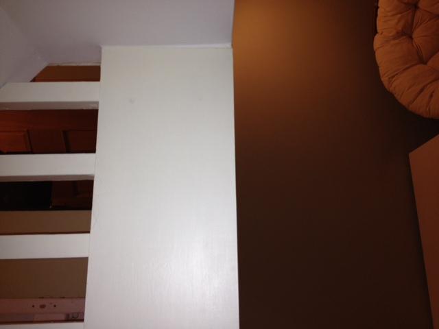

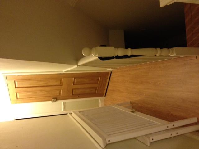

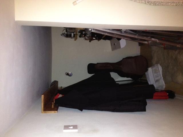

I have uploaded new photo * NB I can't seem to make the rotation work properly. So hope you don't mind tilting your head to the left! *
1 - Stairs down to the basement from our hallway. In front is the front of the house (where the external wall is). The door you see is the entry door to the flat. Imagine opposite on the left is the bedroom door.
2 - The funnel shape of the basement. At the end of this funnel is where is meets the external wall
3- Ceiling of basement = floor of hallway. The left hand wall of the basement (as when you walk down the stairs) lines up with the bedroom doorway, ie the basement extends further left than the hallway.
4 - Close up of the 'funnel' part. The green wall meets the external wall.
5 - External wall. You can see the air brick, although this is not visible from inside the basement.

The basement is somewhat funnel-shaped, with a large square area
containing the main area of the room, and a much narrower area roughly
the same length again toward to the front end of the house. The
picture with the desk faces the rear of the house. The
farthest end of the 'funnel / bottleneck' section roughly (within a foot of)
meets the front exterior step, which must explain the air bricks in
the step. I think this is our best bet for a fan — it's the only
section of the basement with a clear section to the exterior wall, and
there's already airbricks installed in that exterior.
As there is a full ceiling in the basement, we can't see the
orientation of the floor joists, but I would be surprised if they
weren't in the correct orientation for installing our fan ductwork (ie
along the direction of the house).

The odour seems to be coming from the floor of the basement in the funnel section, to the right of the stepladder which you can see in Picture 4. There's in built shelves here.
