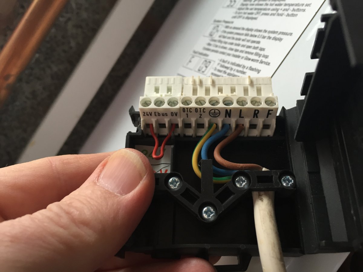

Hi. I am trying to connect the Hive controller to the Flexicon boiler. It is hot water only.
Can someone please tell me where the 1 & 3 connections from the Hive controller connect to into the boiler please? I have read a few forums but unclear as to whether they connect into the installer interface, and if so which terminals the 1 & 3 wires connect to. See diag below. I assume the Hive is a 230V controller not a 24V.
At present I have a timer clock fitted - I assume this needs disconnecting somewhere - or set to no time?
Am I right in saying the 1 (common) should go to N and the 3 (Heating on) to R on the right hand side bank above?
Any help much appreciated.
Thanks all.
Great - thanks. So 1 and 3 on Hive go to L and R as above and disconnect current wiring to these? No other wiring mods needed re timer etc after this I assume. Much appreciated flameport
Hi. I have looked inside the installer interface and found this arrangement so now a bit stuck. Any ideas - there are no leads from L and R here. Thanks.
There is something a bit odd with the original post in that the circuit drawing and photograph of the terminals are slightly different, and the link is not where I would expect it. I would suggest that you start a new thread for yourquestion and put a photograph of your boiler terminals on, without reference to this thread.
