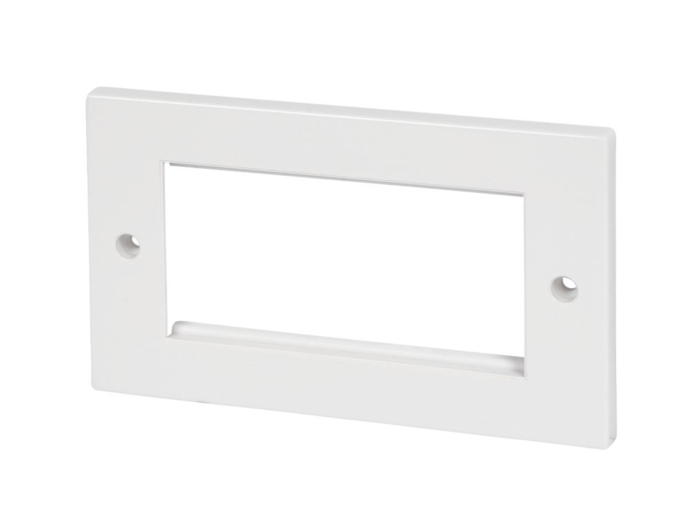

If you want to extend the ring you need to separate out the two feeds to the existing socket. Since it is a double socket the easy way is to replace it with a pair of grid sockets.
These sockets clip into a Face plate you then have two single sockets in the space taken by a standard double socket so as long as the back box is deep enough to can fit the two cables required to extend the ring.
Or you could use a Fuse and a blank to form a single socket and a fused spur from the old double socket.
But it is really important to test that the ring is not compromised during the work.
