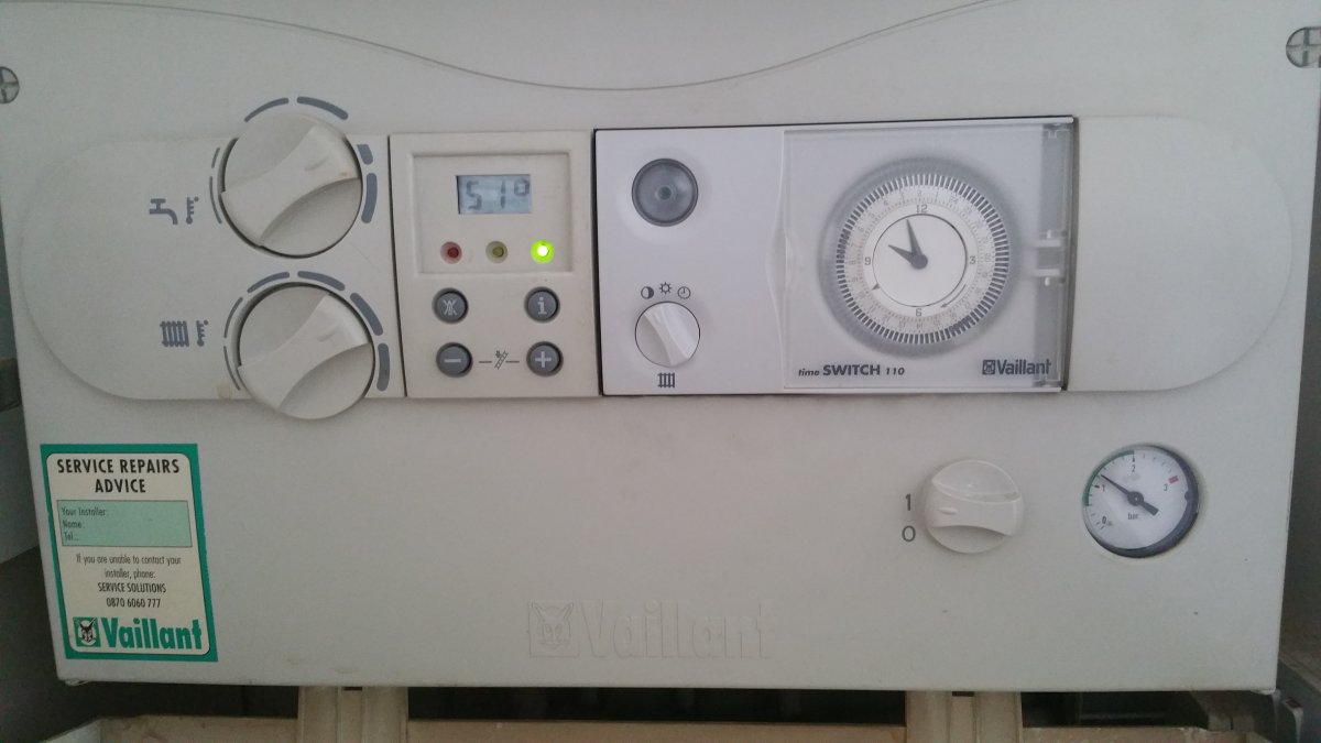

Can u take a pic of the front of your boiler (control panel) and post it on here, just want to make sure its the same as mine. If it is then the dial should point up north (sun icon), which currently for you should turn the boiler on continously.
So to clarify if the dial is:-
Left = Heating perm off
Up = Heating perm on (keep it on this setting permanently after the installation of nest)
Right = Heating on timer (you won't need to use this function again after installation of nest).

Hi Vim
Your exactly correct in what your saying about my boiler operation from the front timer switch panel. You have confirmed to me what I need to know I will try and get this done over the weekend and let you know how it goes. I'm attaching a pic of the front of my boiler but I'm sure it's the same as you just described.

I can confirm that the control panel is the same as mine.

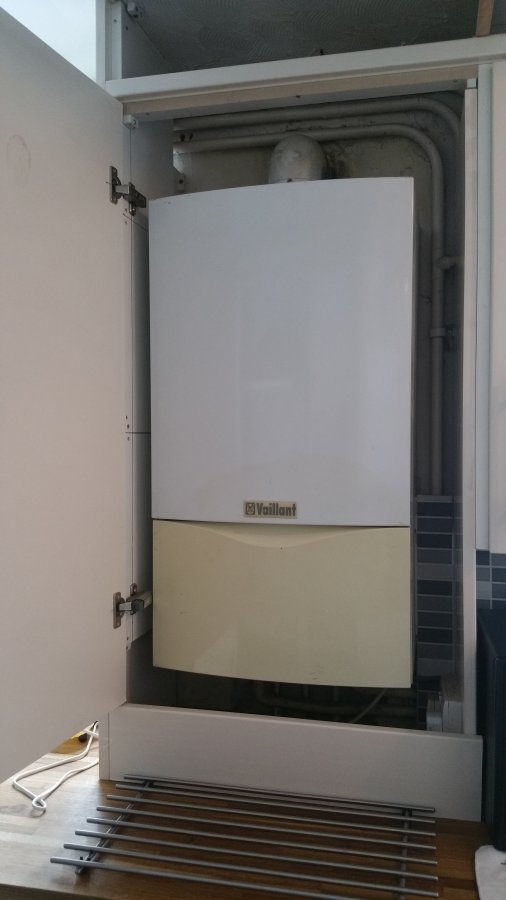

I know you said check the manufacturer guidelines for distance for the heat link install from the boiler but can I check where you placed yours in relation to your boiler.
Its not far from the boiler.... it is more than the recommended distance though.
where is your boiler at the moment and is it going to be a problem fitting it as per the recommended guideline?
just trying to understand what the challenge here is?

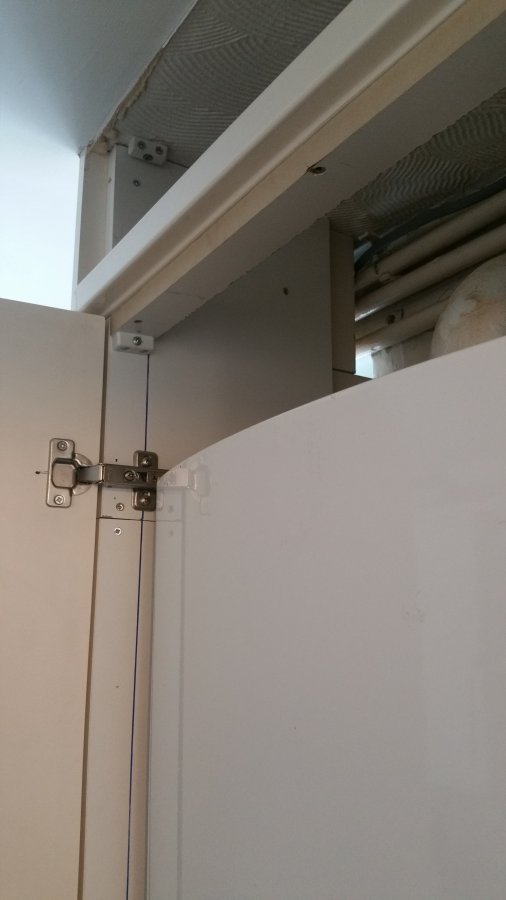

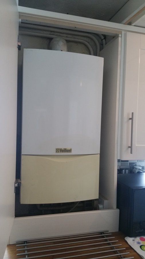

The problem I've got is that my boiler is in a cupboard that is quite small and the only place I can see where I can put the heatlink is the top left corner which has the furthest distance from the boiler. I'm attaching some pics so you can see what I mean. When I checked the nest install guidelines they say 30cm away from the boiler so it doesn't have any interference from the boiler when communicating with the nest thermostat. If this is the only problem then surely it would be ok if I install it in the top left corner that way it will communicate with the nest thermostat ok because it will be on the next level up in my house towards the left of the boiler so no signal should be blocked between the two.

If there is no other place to install it then i would just install it where you said you would.
I think it should still work... if it doesnt i dont think it will damage the reciever (maybe someone else can confirm this). In which case you can think of plan B then.
