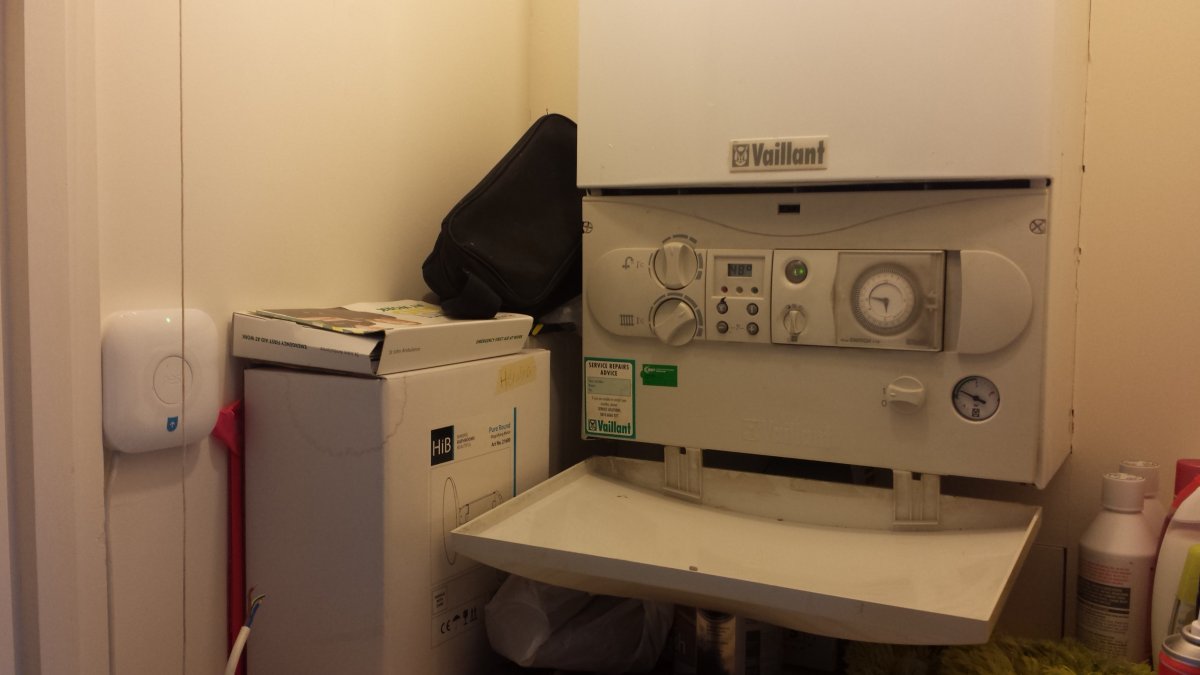

Installing a NEST to a Vaillant Turbomax
forgot to attach

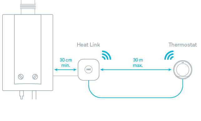

Ok thanks for the pic. I can see your heatlink is the recommended 30cm away from the boiler. I'll try and find out more info about why it has to be 30cm away from the boiler.
The speed controller for the boiler's fan creates and radiates a small amount of spurious radio frequency energy. If the receiver of a wireless system is placed too close to the boiler then the radio frequency energy from the boiler can degrade reception of commands to the boiler.

Thanks for that info bernardgreen I think I've found a way round this. I will run a longer 4 core cable from the boiler to the heat link receiver and put the heat link on top of the cupboard next to the boiler which will give me more than 30cm distance from the boiler.

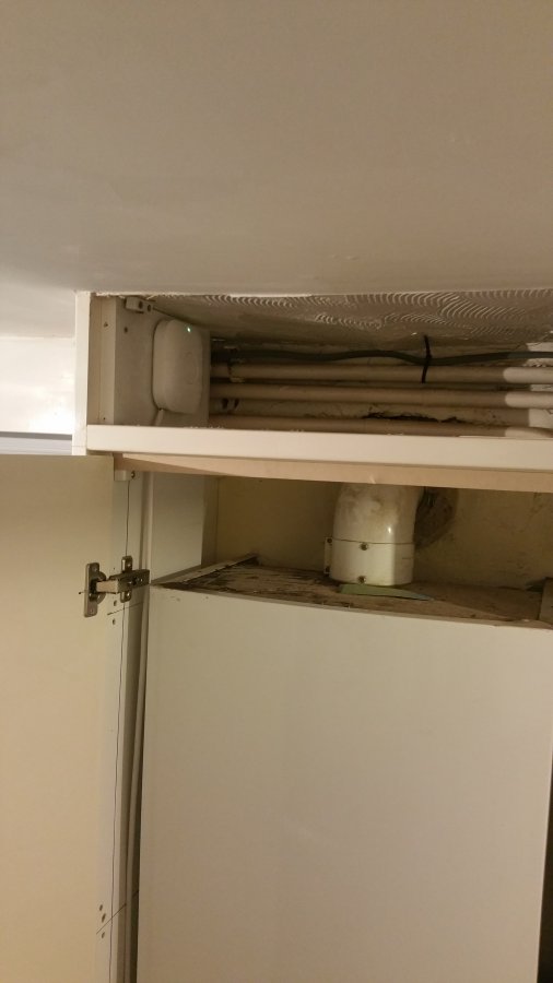

Hi everyone just giving you all an update I followed mikeyd instructions and installed my nest successfully. I put the heat link 20cm away from the boiler and everything is working ok. Thanks for everyone's help.

I'm saying that they have put 30cm in there for a reason. With Honeywell controls, it is bizarre how critical that minimum distance is.
You may get away with it, you may start getting problems further down the line. Tricky to say.

Here is a picture of where the heat link is from my boiler. It is 20cm away from the top of the boiler.
