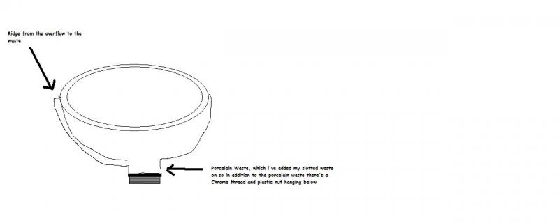

Hi, just been checking the forum to see if these questions have been asked before and i can't see any so here i go.
1. I have a above countor wash basin to install, ( with overflow built into the sink) ( so although it's perfectly round there is a ridge running down the back) it came with no instructions, no fixings or anything. How do i securely fix it to my standalone basin cupboard?? do i core a hole just big enough for the waste/overflow noggin and glue it in?? seems a bit of a loose way to do it??

Not sure about the basin, these can all be different, maybe a pic would help if possible?
Hot water, 15mm is fine. 22mm used when fed from a cylinder, gives a faster flow to fill the bath quicker. Just step up to 22mm at the taps.
If the cupboard is designed for the sink it should have a hole for the sink to sit into, if not the ridge on the back should have two holes, measure them off and drill, insert hexagon bolt screws (sorry don`t know the right name) and they will hold the sink.

I'll get a picture of the basin to you can all have a look but for now here's a quick (very amateur drawing)
The unit doesn't have any holes in it.. yet ;) and i can't see and think on the underside of the sink to attach it down to.. :(
