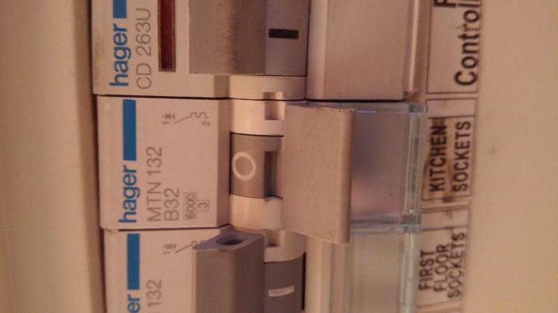

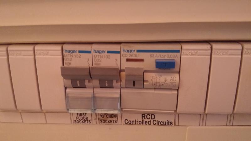

My sockets are to be screwed to the wall next to the appliances so will be accessible. the ring main is protected my a 32ma rcd it seems at the consumer unit. Why is it not a good idea to use double gang sockets if two singles can be joined together on a ring with potentially a short cable to Join them together? Thanks for all of your help by the way!

That is an MCB there may be RCD's fitted before the MCB in the same board.
Rules have changed and all NEW sockets need RCD protection so pictures of the whole board and hope some one can say if already RCD protected or if the MCB can be swapped for a RCBO.
It's that RCD which is all important in working out how to do it.
