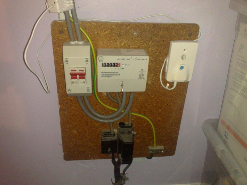

Thanks to all for the advice! I obtained a REC2 from a local factors for £14, fitted it to the board and added the tails out of the bottom of the REC2. The meter fitter then wired it in when he came.
The end product.
The electrician who did the last rewire did a neat job of the tails (now pulled about a bit in the picture) so with the further-reduced space there isn't room for the sensor for the wireless power meter. That will change when I replace the CU later (yes, notified, Part P) and leave more room for the clamp.
So I now have a 100A MK isolator and 2-module enclosure for the spares box!
I can definitely recommend the REC2 - very easy to fit. Plus it identifies the conductors on the OUTSIDE of the box. Very useful.
On the service fuse at the bottom of the photo, what has happened to the lower part of the service fuse unit (i.e. the tapered bit that covers the incoming cable cores)? - it appears that the inner cores of the live service cable are exposed, where the outer covering has been trimmed back by the DNO - that part is normally enclosed by the taper lower section.
I cannot see any protective equipotential bonding on the Main earthing terminal. Does it terminate at the Consumer unit?
These aren't always fitted. A lot of the cut-outs round here, especially from overhead cables don't have them.
