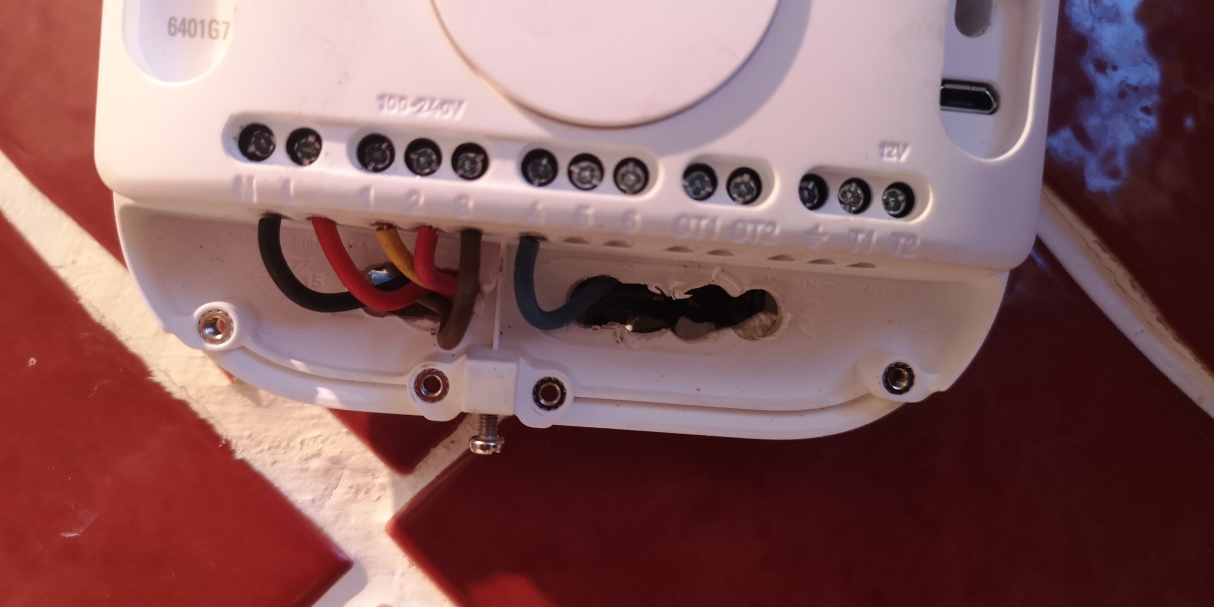

So after reading online and being led to believe this was simple, I'm stuck.

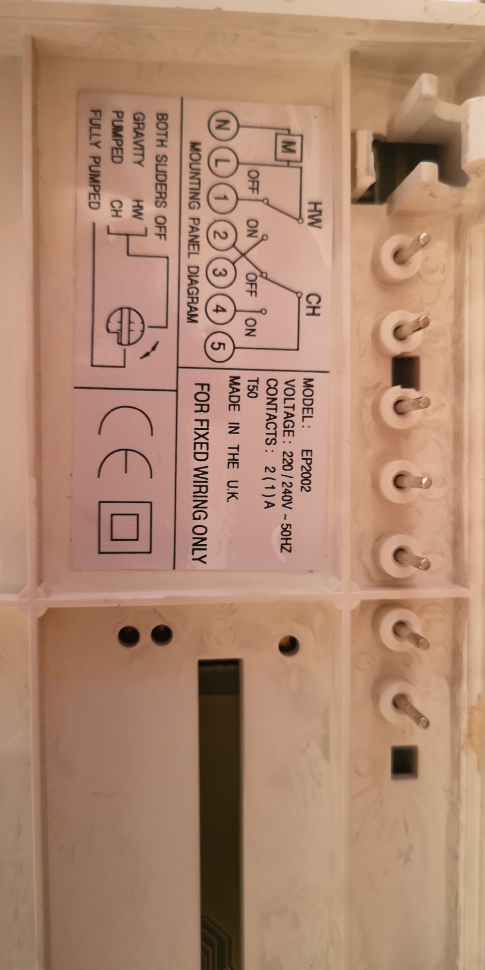

I originally had a potterton controller ep2002. Wired as follows...
Not that terminals L and 5 are linked.
I hkave rewired as follows and the nest unit is on but the boiler is not. Not sure what I have done wrong.
Can anyone help?

It’s just a matter of moving the from the EP terminals to the Nest terminals that have exactly the same function. Their functions are shown in the diagrams you have posted, so based on them:
NEST HEATLINK
Black wire in EP N ..... Nest N
Red wire in EP L ..... Nest L (for now discard the link to EP5 we’ll come back to the links later)
Blue wire EP 1 Hot water off.....Nest 4 Hot water satisfied
Yellow wire in EP 3 Hot water on.....Nest 6 Hot water call for heat
Red wire in EP 4 Central Heating on... Nest 3 Heating call for heat
Then add links so that Nest terminals L, 2 and 5 are electrically connected together.
It would appear (can’t see it clearly) that as well as the loop, there may also be a brown wire in terminal 5, that will also need to be connected to the L (connect it to terminals L, 2 or 5 whichever is easiest)

Unfortunately that didn't work.
Boiler had power but when you turn up the nest thermostat the boiler turns off.... No heat.
Swapped terminals 1 and 3.
Boiler has power. Turn up the thermostat and you hear the switch but no heat.
I'm at a loss. Time to call someone in?
How's it wired now after Stems advice? Photo?

At the end of the day terminal 4 from the EP becomes live when it the EP switches the heating on, terminal 3 of the nest does exactly the same thing. Have you checked that the red wires that were in the EP L and 4 are connected as below and not the other way around? Is terminal 2 connected to L?

Have you checked that every wire has been moved as I described and all of the links are present, it's easy to miss one
Have you checked every terminal to make sure that the connections are secure and the conductors are clamped under the terminals not the insulation? Nests are fiddly beasts for those of us that are used to them. Bad connections are common.
