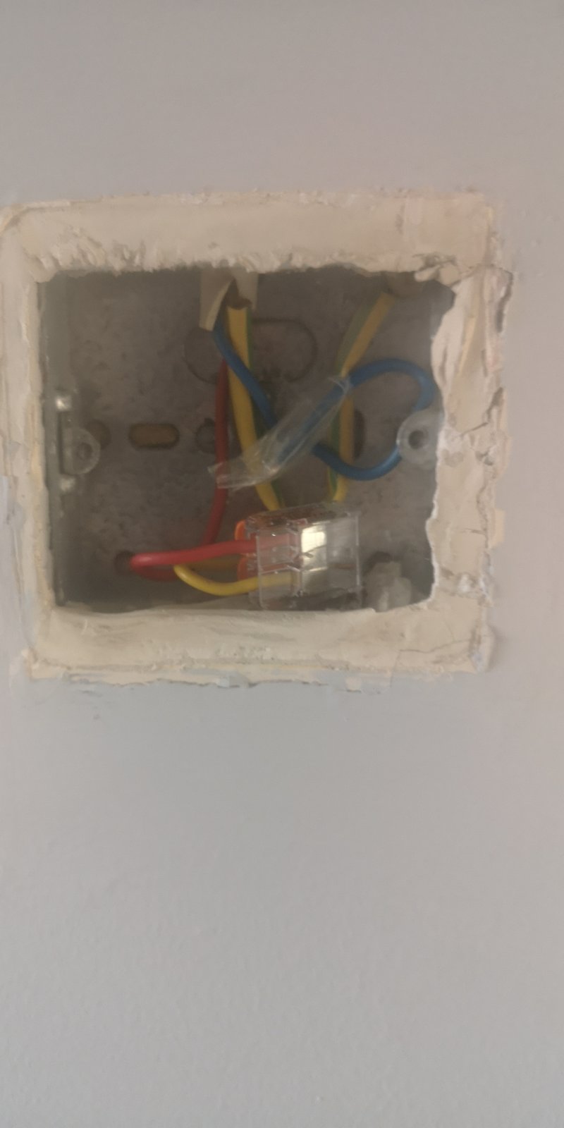

When doing this I have found that the cables that went to the old thermostat still have a live supply going to it. So when I fire up the central heating, the wires that went to the old thermostat go live. Why is this?
I wanted to reuse these cables and plug them into t1 and t2 but struggling to find where they originate from at the boiler. Anyone have any ideas?

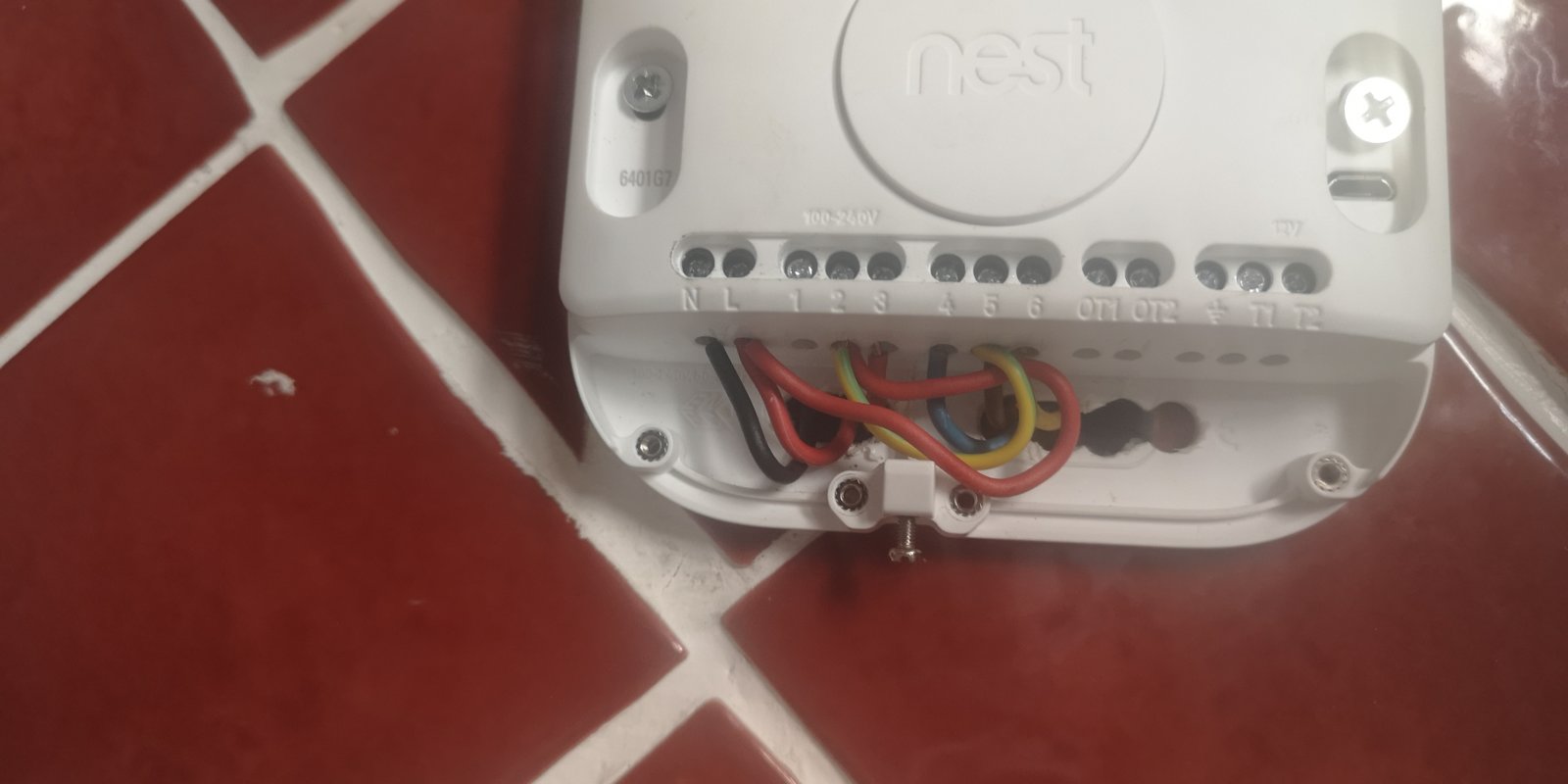

I think, This is because it was left in situ, and still part of the circuit. Read @stem’s reply (4t reply on this thread). If I understand it correctly (I’m trying to learn myself), the heatlink replaced the programmer on the red tiled wall. To fit the thermostat in place of existing thermostat it’s a case of connecting the relevant wires from existing thermostat into nest? Photo of thermostat wiring on wall and one of nest may help.
So find attached all pics.

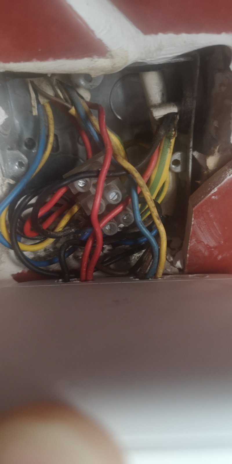

Nest is wired as per Stems earlier thread and all working a treat. I have also included a photo of the junction box and wires directly behind the nest.
When I heating only is switched on then the wires from the old thermostat go live. Pic with grey/blue wall.
Do you have t1 and t2 on your base for the nest?

Because the Nest carries out the functions of the room thermostat, the old wired thermostat needs to be decommissioned to prevent it overriding the Nest. It can't simply be disconnected as this would leave the heating wiring 'open circuit' and it will not operate. The thermostat can be decommissioned in several ways. At the moment, your existing thermostat has been removed, the two live switching wires (red and yellow) connected together, and the neutral isolated.
If you want to disconnect the cable to use it to connect T1 & T2, then trace the cable from the thermostat back to its origin. Note where the red and yellow wires are connected, and then disconnect the cable completely, including the neutral and earth. Finally insert a wire to join the two terminals where the red and yellow wires have just been removed from together so that they are electrically connected. The original thermostat cable will now be electrically disconnected at both ends.
This would be good opportunity to make the existing wiring safe. That junction box is messy and rather dangerous. I can't see that it has an earth connection to the metal box itself (the thermostat back box shows how it should be done) and the wires seem to lack protection at the bottom. The wires should be enclosed with a sheath where they enter the box (to protect the wires chafing on the edges) and any holes that they pass through should have the additional protection of rubber grommets. Those at the top are correct.

Big problem I have is that I cant trace those cables back to the boiler end. Could they possibly enter the boiler first and then into the junction box for the nest?
4 cables enter that junction box at the boiler.
I'm assuming two are the ring main, one for boiler power (switched) other for the rcd?
I was hoping one of them would be the thermostat but from what I can see that's not the case.
