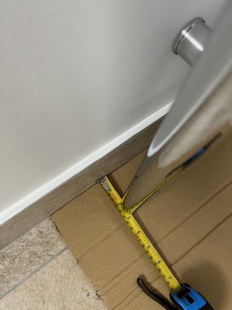

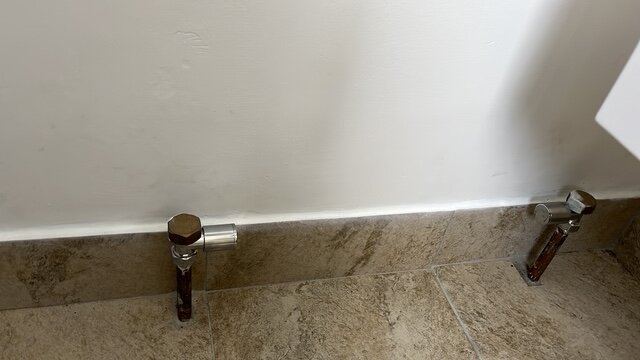

Hi
I am installing a towel rad, the pipes are already there ready and valve fitted, pls see pics. I have fitted required parts to the rad, pls see pics.
I have looked on you tube but all in all vids they first fit the rad on the wall then do the piping which don't apply to me. I bought rad with same spacing between pipes as the rad I had before.

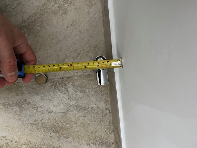

1. The first issue is rad bracket depth to wall. I have the 4 brackets on rad, as in pics they are about 70mm from wall but valve centre from wall is 40mm as in pics. So I need to cut the bracket by around 35mm? I will have to cut both parts of each bracket, pls correct if wrong? By Hacksaw?
Also need to make hole for small holding screws, drill will break the plastic I guess, what's the best way?
2. As pipes are ready, what's the best way to measure brackets locations on wall? Is it best to cut the 4 brackets, assemble them on rad, place rad on the two valves and pencil 4 brackets locations on wall?
How much to allow for the nut which connects rad to the two valves? Or may be I don't need to allow anything as rad sits on valves and tightened? I don't need PTFE or Jointing compound here as there is washer.

I think you can put the valves on the rad and connect them to the pipes with one of these.
The pipe section can be cut down to the length that you need to bring it away from the wall. Your curent valves are straight valves and you will need to swap them for 90 degree or corner valves I think.
If its too close to the wall then you cant get a towel behind it.

Locate the brackets that fit onto the rad to where you want them on the rad, sit the rad onto the valves, supporting the rad on a box or similar, then push the rad against the wall and mark the position of the bracket legs. The centre point is the centre point for the wall tubes.

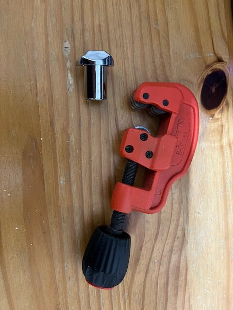

A joiner Hack saw will be fine. Anything but masonry - start with a very small one
Careful with a hacksaw, if it goes off straight, which hacksaws are very good at doing, then it's a right PIA to correct. Best hand tool, if you have one is a fine tooth wood/plastic saw and a vice
1.5/2mm HSS drill will be fine, just drill the outside tube
I managed to cut the brackets with clean perfect finish , remembered I had adjustable metal pipe cutter in the garage.
