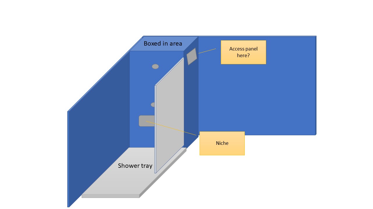

The back corner of my bathroom has an area which is boxed in with water supply, heating, waste pipe and various wires running from other parts of the house down to the ground floor consumer unit just below.
This is all boxed in and tiled with a concealed shower valve and then shower tray butted straight up to it. It is all CLS stud work and cement board.
There is a small niche in the shower which goes in to this boxed in space.
What I want to do is put IP65 LED strip lights in the niche and then a small access panel either in the ceiling or to the side of the boxing where I can place the driver / transformer then get it all certified.
Given this is a service area with other wires running through it, built recently to code I assume having wiring in there is okay as is an IP 65 light if it were 240v as it could all be wired in.
However, as I want to use 12v lighting the question is can I put an access panel and transformer in there?
I've done a crude diagram to help explain!

The point has been missed here. This work is notifiable under part P and I understand the process and how to go about this.
What I was wanting a second opinion on is the status with regard to the boxed off area, putting an access panel and electrical devices such as transformers etc.
As a CLOSED service area behind the shower with existing electrical wiring is it outside of any zones I need to consider as far as I can tell.
If I opened up this space (removed the boxing) it would clearly be zone 1 and then everything behind it already becomes a problem.
This is not the intent, just illustrating the point.
Regardless of the electrical work I plan to put an access panel in so I can have a stop valve for the entire bathroom on this floor and above.
Does this materially change this boxed off area in terms of its zones and requirements under part P?
Would it be permissible to put a transformer in this area.
The point has been missed here. ... As a CLOSED service area behind the shower with existing electrical wiring is it outside of any zones I need to consider as far as I can tell. If I opened up this space (removed the boxing) it would clearly be zone 1 and then everything behind it already becomes a problem.
Zones do not extent below the surface of a wall, so I agree that within the boxing would not not be within zones, so work in that space would not be notifiable..
Regardless of the electrical work I plan to put an access panel in so I can have a stop valve for the entire bathroom on this floor and above. Does this materially change this boxed off area in terms of its zones and requirements under part P?
I don't think the access panel makes any difference. I certainly don't think it would if one had to use a 'tool' (e.g. screwdriver or key) to open the panel. However, even if a tool were not needed, it seems to be accepted that the inside of a cupboard is 'outside of zones', even if the door can be opened without a tool, and the panel would be no different from that.
On the above basis, I would say yes.

"If it is accepted that within the boxing (even with the access panel) is 'outside of zones'"
This is the key point and what you are saying seems to concur with what I was told although no one seems prepared to make a cast ion assertion.
Please advise where the lights themselves will be situated. Even if they are 12v, they may need to be supplied from a specific type of power supply.
The problem is that the Building Regs and BS7671 do not contain much explicit detail as to what counts as being 'in zones' (other than in 'obvious'/straightforward situations), so all you will be able to get are personal opinions/interpretations, hopefully based on common sense.
I've offered my personal opinion/interpretation - but it will be interesting to hear what others say. Pragmatically speaking, if there are differences of opinion, I don't think you need to worry too much, provided what is done is 'reasonable'. Of course, it's ultimately the view of the person who undertakes, certifies and notifies the work which matters.
