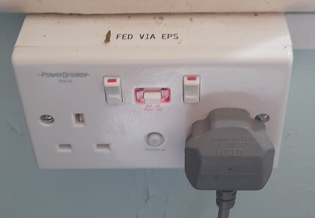

I can see how a drill, hedge cutter, and the like may say don't use in the rain. But in the main, any plug in item, any restrictions stop at the socket, OK we may find a loft socket with a 3 amp max sticker on it, but in the main, if there is a socket we can use it. 1785669158550.png This one is clearly marked fed via EPS, so if items should not be plugged into a UPS, or EPS supply, then yes the instructions should say so.

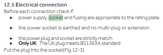

As to on the packaging saying not suitable for use outside, or not suitable for non RCD protected supplies etc, I have only seen the latter with installed items. So this
Is fair enough, taken from a tumble driers instructions, but in the main the 13 amp plug can be put into nearly all 13 amp sockets, and with plug in solar one is hardly going to leave ones window open in order to plug it in, so only option is an outside socket, and to have a warning on the box, so one can see before buying about unidirectional RCD, using fuses rather than a MCB or RCBO would just go over the head of most tenants, if they have a handy outdoor socket, why not use it for a solar panel.

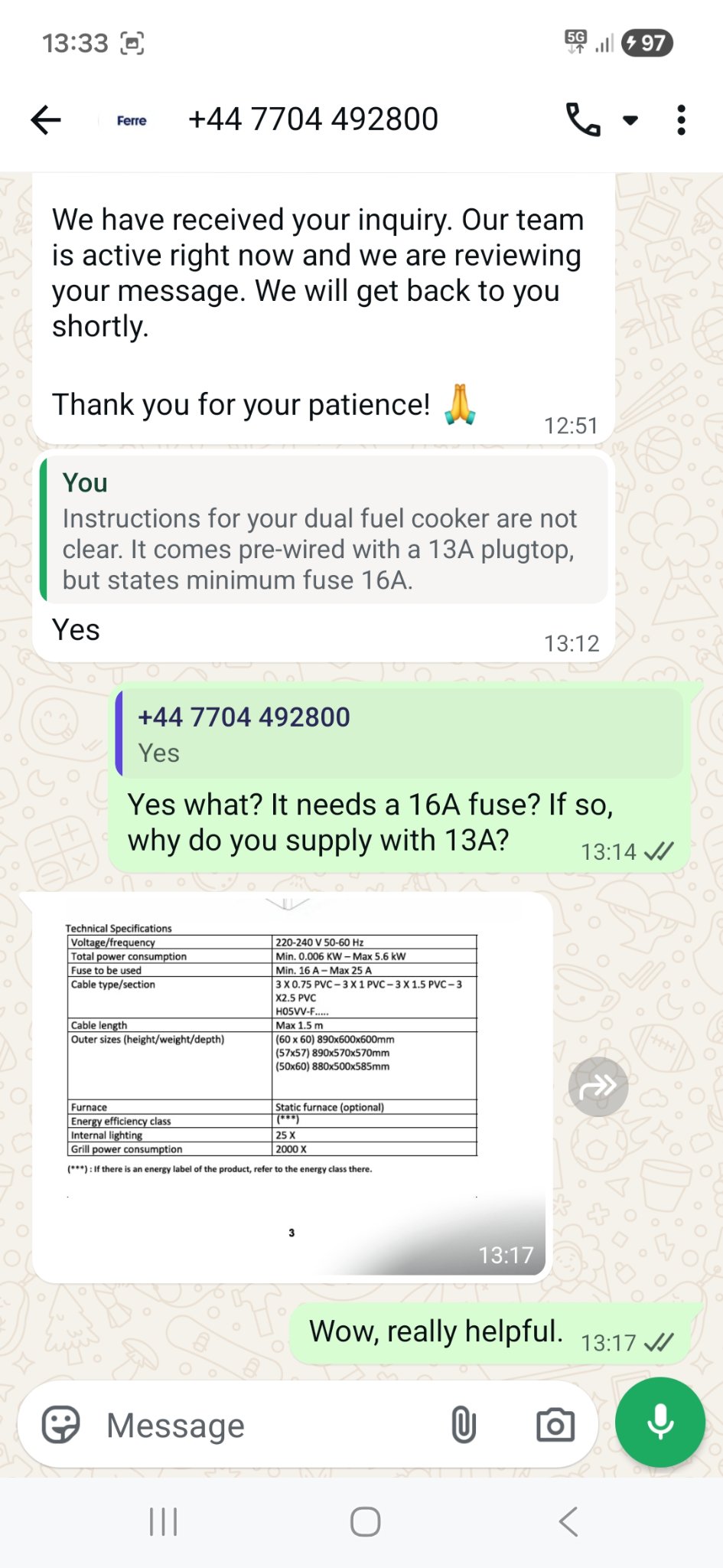

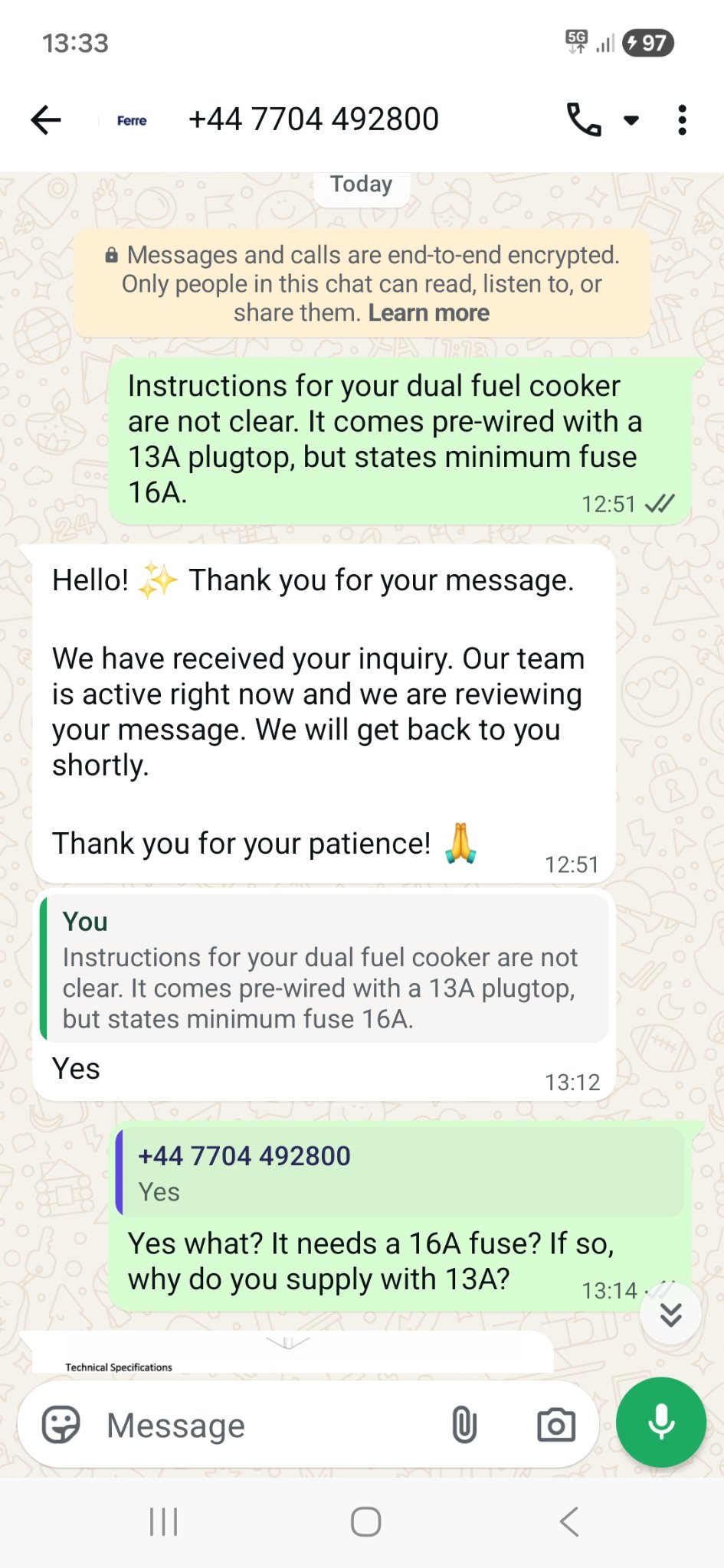

I had install a dual fuel gas cooker today. The instructions are clear as mud. It comes pre-wired with a 13A plug, but states a minimum fuse of 16A - 25A. I'm guessing that is for being hard wired, but why muddy the waters?

Presumably that refers to circuit protection ?
Not sure why they need to specify anything on a socket circuit
Could be. Here is what I have had back via WhatsApp messaging with them. I also meant to provide a link above, but here it is: Ferre

It's not for being"hard wired" as its supplied with a plug so should be fused at 13 amp
They're referring to the circuit protection but it's pretty much irrelevant on a socket circuit all being well
Still not clearly written though. I presumed as much, customer wanted it checking for belt and braces, so a spark is attending
