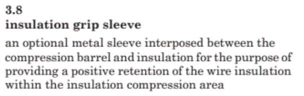

Stop buying cheap nasty crimp terminals!:p:p A metal part grabs the wire insulation also in good crimp terminals...
BS 7727 sadly says it's 'optional', hence most terminals for sale are crap.
Decent quality Panduit ones...
