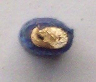

OK, not a brilliant photo (will try again later in the week with a more appropriate camera), and some consequences of he hacksaw, but this is a section through a crimp I made today, of a 2.5mm² solid conductor in a blue insulated crimp, made with the TLC ratchet crimpers which BAS frequently promotes. I think even the poor pic shows some 'issues', although there could be a cold weld there:
It looks to me as if the fact that conductor did not fill the hole in the crimp has allowed the left hand side (as viewed) of the crimp to collapse and split under compression, not to mention some lateral voids into which I suspect that creepage might occur over time. However, the last thing I would claim to be is a metallurgist or authority in these matters, so any comments would certainly be welcome!
Kind Regards, John.
