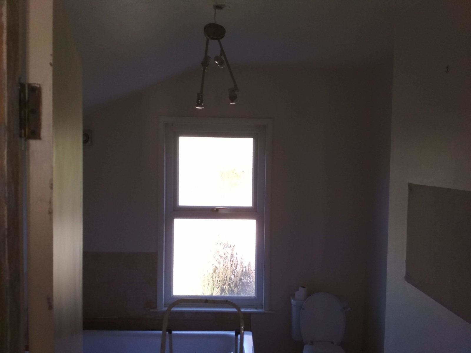

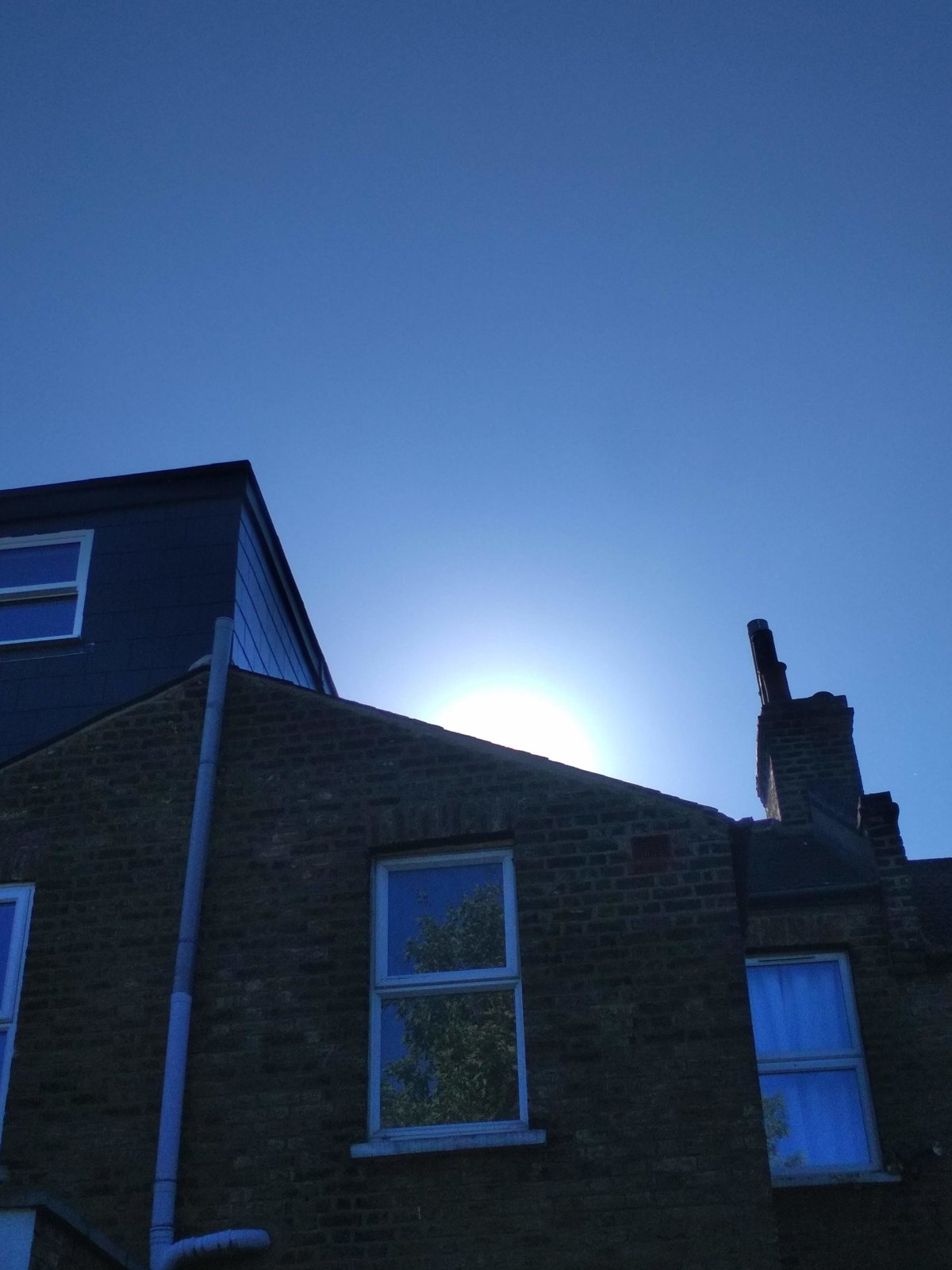

Yeah the previous owners did an informal loft conversion which we have access to but there's no real void above the rear bathroom. Here's a couple of pics. When the time comes for a loft conversion we can do a full L shaped dormer like the neighbours

I've just seen the design of the room - being that the ceiling is pretty much in the eves of the roof, loft insulation is probably not going to help!!!!

If money is no object then by all means insulate everything - that will deffo give you the best results. But if there is a budget, you're better off going for the insulation in the roof and an adequate radiator - I can see from the pic though that this will be difficult because of your roof structure.
I'd go with the celotex type of insulation in the eves if it can be fitted in there and then standard loft insulation above the rest of the bathroom. Again, if you have the money, go for the wall insulation too it will help, just not as much as the ceiling insulation.
