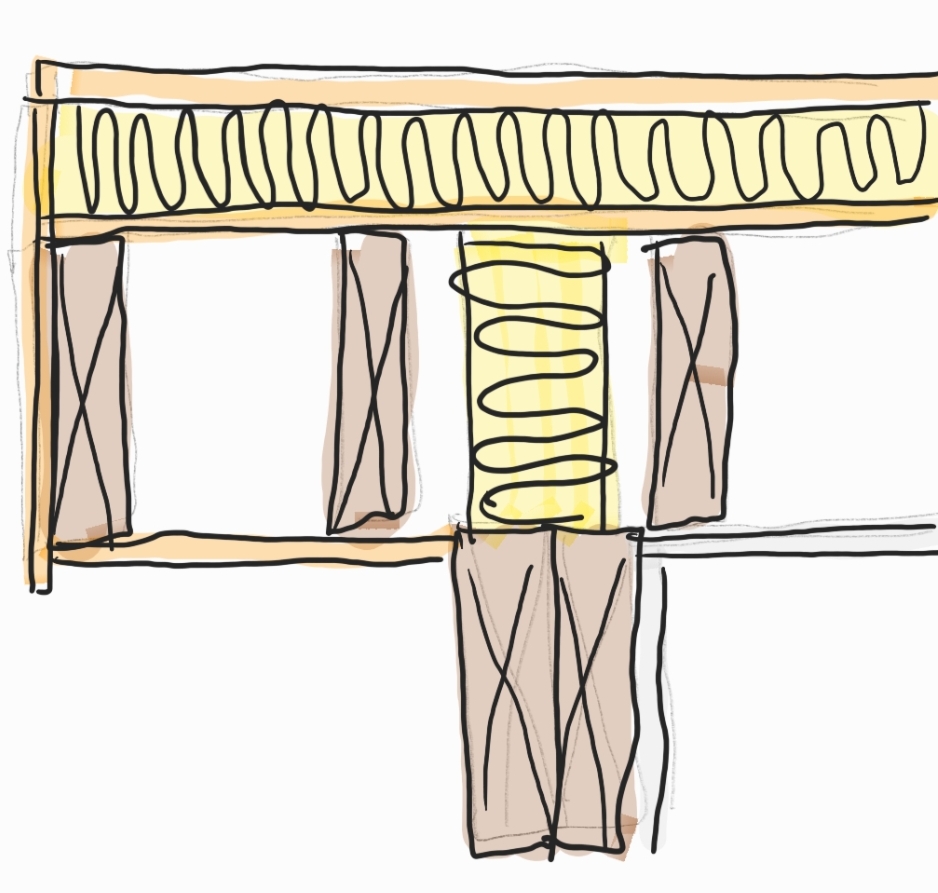

Hi Garden detached room under construction .
Warm roof will be used (18mm osb then 100 celotex then 18 osb)
Query : Insulation with the eves at end of joist runs, as there are noggins etc
please see attached Before answering - thanks
  • annexx.pdf

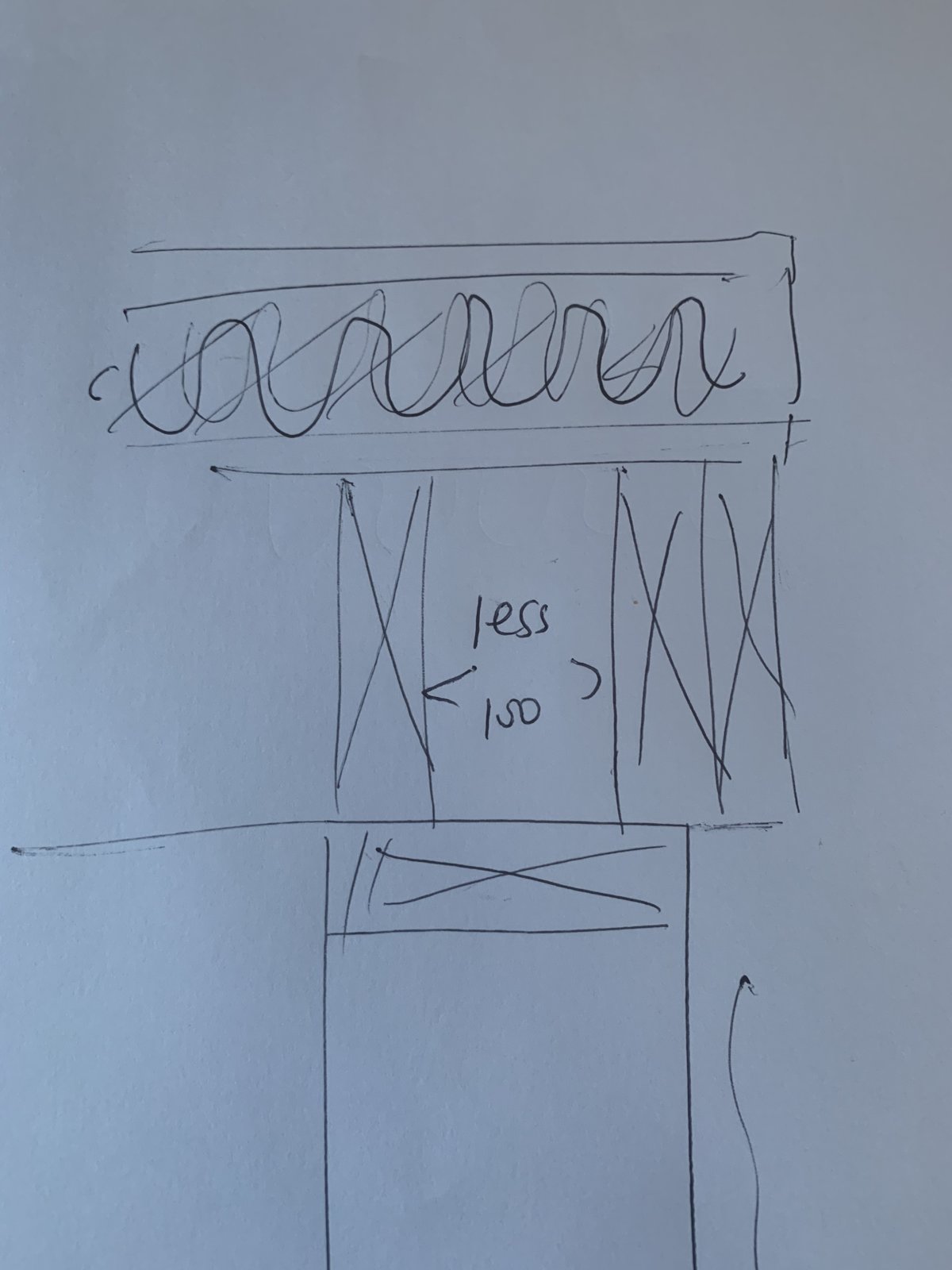

are you suggesting that noggins should not restrict 100mm celotex being above walls? see picture
The idea is that the wall insulation meets the roof insulation to form a continuous layer.
You would form the roof, with the joists either side of the wall as required and fixed with noggins as required, and place the insulation above the walls in the void.
