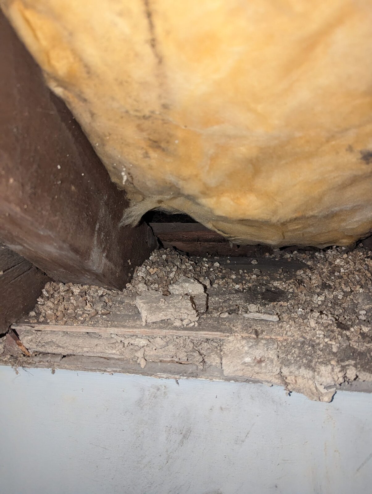

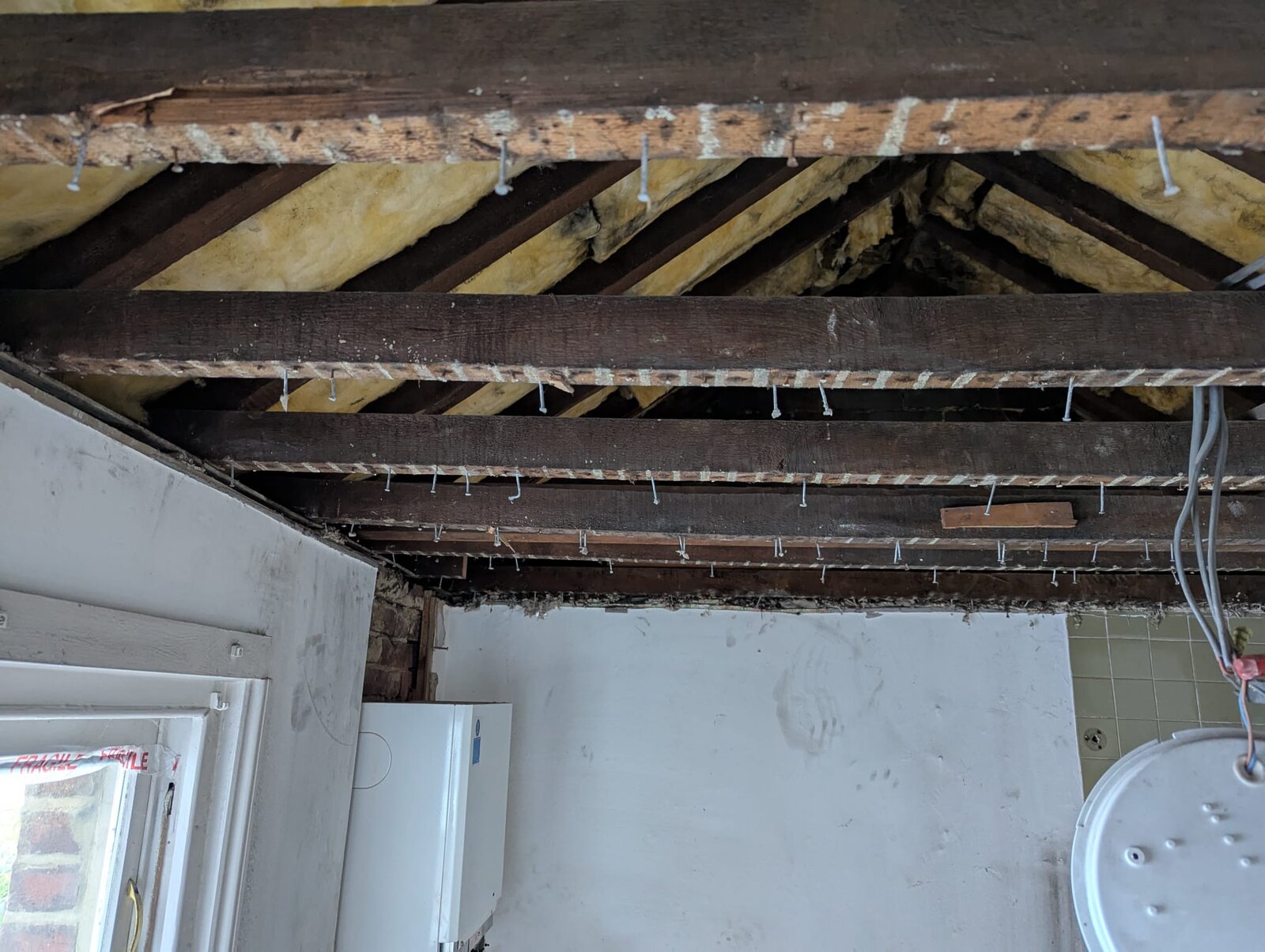

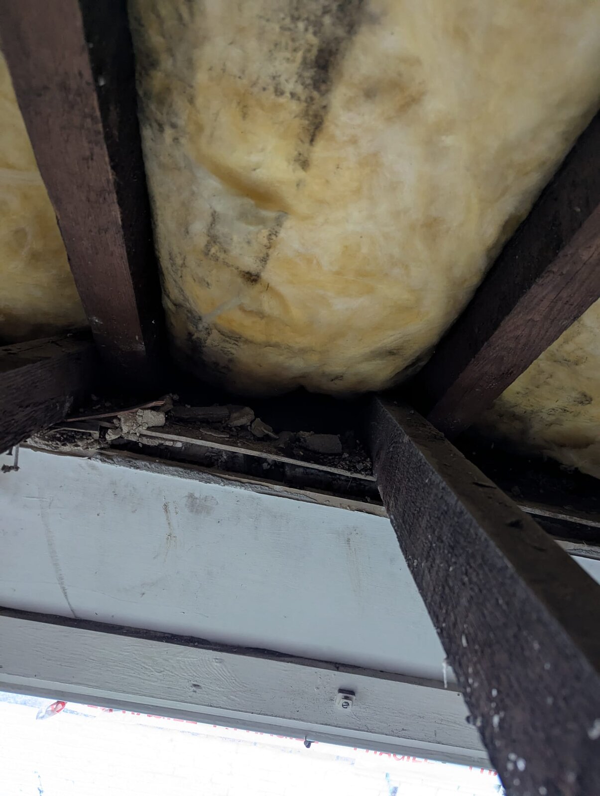

Hi there. I'm vaulting the ceiling on a small terrace extension, 3x 5m (kitchen downstairs, bathroom upstairs). I don't know when the roof was last done, but suspect around 50's/60s. The original extension likely pre-dates this as it had lath and plaster ceilings. It has terracota tiles on top, then a layer of membrane, then a layer of white mineralwool/fibreglass insulation, then the rafters. I've seen a lot of "how to" advice on insulating lofts where they recommend a 50mm air gap between the membrane for airflow when installing ridged insulation between the rafter, however there does not appear to be any ventilation under the membrane (inside the roof) in the existing construction of my roof, so I am wondering if this is necessary in my case? Is that ventiation occuring on the other side of membrane, and the rather modest layer of mineral wood/fibreglass insulation between the membrane and rafters enough to prevent cold bridging and condensation/wood rot issues? Basically just wanting some advice on how proceed so I don't put a lot of time, effort and money into a solution which is not up to regs (work will be inspected by building control, as need to install ridgebeam), and/or not going to be healthy for the longevity of the roof.

That will need to come out and be done to current standards - 50mm air gap, layers of PIR. The fact that what was there apparently didn't cause a problem is irrelevant.
You have two options. War or cold roof.
1. Go with a vaulted ceiling - remove the insulation, fit 100mm of PIR board between the joists allowing for 50mm air gap between top of board and roof then vapour barrier ( polythene sheet) the either insulated PB or 25mm PIR + Plaster Board. - you can adjust the ratio to keep the air gap. 75mm between and 50mm below)
2. Remove the insulation, keep the lower ceiling, plaster board it cover it with 300mm of roll insulation, as its a kitchen I would poly sheet it between the bottom of the joists and the PB, but that is up to the BC in a lot of cases... but its £20 roll and a stapler..

Thanks for your replies.
Vaulted ceiling is the end goal, with collar ties and ridgebeam to take load and prevent spread, so ceiling joists can then be removed.
So (and please correct me if I've got this wrong), to get to current standards that BC will be happy with, I need to remove mineralwood/fibreglass roll insulation, and pack space left above rafter with some batton (or I guess could leave the insulation above the rafters?). I don't need to increase the depth of my rafters (which are 100mm), and can insert 50mm PIR (allowing for 50mm air gap), then over board with 75mm PIR + pasterboard? Is there anything I need to watch out for in terms of venting at the ridge?

You might want to check the application of that... its designed for new roof construction, in-situ roofs are normally dealt with on a best endeavours route with the BCO..as older roofs rarely have membrane or sarking or felt that conform to the rest of the spec... making the guidance either useless of counter productive.
