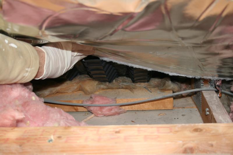

So the best plan looks like taking off the kickboard at the back of the storage area and looking where the draft is coming from.
Not sure how to join/seal the foil insulation at the top of the wall though :(
Hi guys,
So I finally got round to removing the kick board at the back of the storage area and have found this:
I'd like to make the insulation bubble the roof line, but how the hell am I supposed to seal this to the top of the wall? I can't even see the top of the wall :(
Any ideas?
BB
You just make sure your rafter insulation meets the Rockwool that can be seen poking out the floor in your pic, you can only do the best you can. If necessary just shove a bit of rockwool in the gap if there is one.
At least you don't have to worry about blocking the ventilation, that's what those ribbed plastic trays are sitting on top of the rafters.
