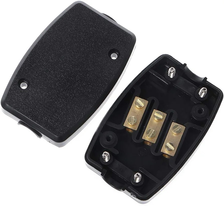

For me, I have just used a 13A flex connector to extend the lead, simples!
That's just a junction box with cable clamps. We havent even got around to arguing about the size, shape, type and colour of the junction.
So after that you then used the correct wire which you fitted into a plug so the moulded plug that comes on it is void.

which would mean 2 junction boxes if we want to use the original moulded plug, but if not one followed by cable and a plug of the same amps.
Ideal product for the situation

Eureka - of course, you can cut the socket off the extension lead and use that plug and flex - only one junction box then.
