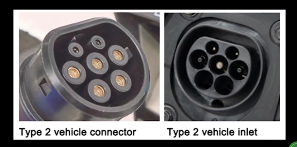

It seems we have type 1, 2, and 3. And the type 2 upload_2022-1-6_12-36-11.png upload_2022-1-6_12-36-31.png is the one in question, the connector on the car
has 7 connectors with three phase versions, and two as seen here not populated with the single phase version. So some cars when plugged into a type 2 charging station get 22 kW others only 7 kW.

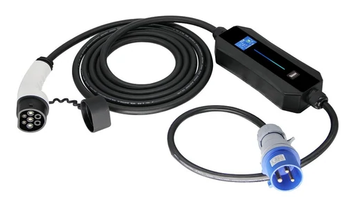

It all started after watching a U-tube video about using this upload_2022-1-6_12-50-32.png type of charger which simply plugs into a 32 amp socket, I did not realise they existed, variable charge rate 8 - 32 amp and since the charger is not fixed, all the safety features which an installer of an EV charger should consider, supply type, type of RCD etc. All go out the window, as the installer is only fitting a standard 32 amp socket, which could be used for a welder for example so not covered by the rules for EV charging points.
It also means a large saving, the charger retails at £270 the video
was an eye opener as I was unaware you could get a 7 kW plug in charger, I though only 2 kW versions were available.

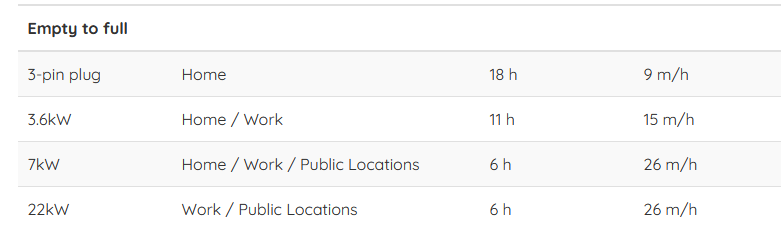

I looked at the link and note
So a 7 kW charger takes 6 hours and a 22 kW charger also takes 6 hours, so it seems it also only uses one of the phases available?
For AC charging, the charger unit is in the vehicle - the 'charger' on the wall is just a box which switches the AC on and off, and has some other electronics to limit the rate of charging to some predefined values, plus various safety features.
Most vehicles have a single phase charger which is up to 7.2kW. Some have 3 phase which in theory is 22kW. Some vehicles may have charging devices which only support lower rates such as 6kW.
Most EVs use a Type 2 connector. A few older ones have the Type 1, which is electrically compatible with Type 2 so just needs a different cable - Type 1 at the car end, Type 2 on the other end.
For most, it's a cable with Type 2 on both ends.

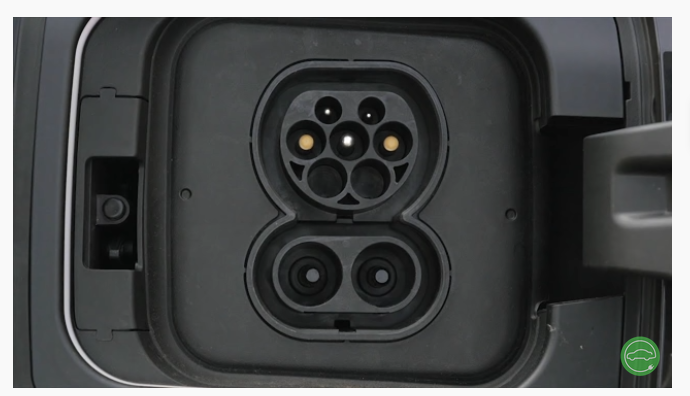

DC charging uses the CCS connector, which is the same Type 2 connector with two extra connectors below it.
The large connectors are DC, and the smaller pins in the upper connector are used for communication between the vehicle and charger.
