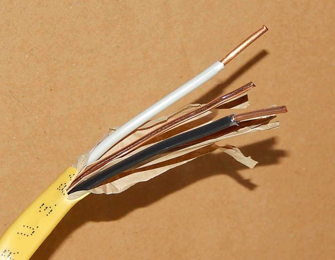

Doubt that's a "real" photograph, the cpc is at least as heavy as the line cores
According to the web site the product is "in development" designed to make joins in ROMEX® brand NM cable - seems to be US stuff.
If you Google NM cable you'll see that all of the cores appear to be of equal csa.
That picture certainly looks like a graphic representation, but yes, the ground wire in NM cable is the same size as the other conductors in sizes up to 10 AWG. This example (hastily stripped to show the construction, hence not a nice neat trimming of the sheath!) is #12 size:
Smaller grounds were used in NM cable up until the late 1960's, and are still used in #8 and larger.
