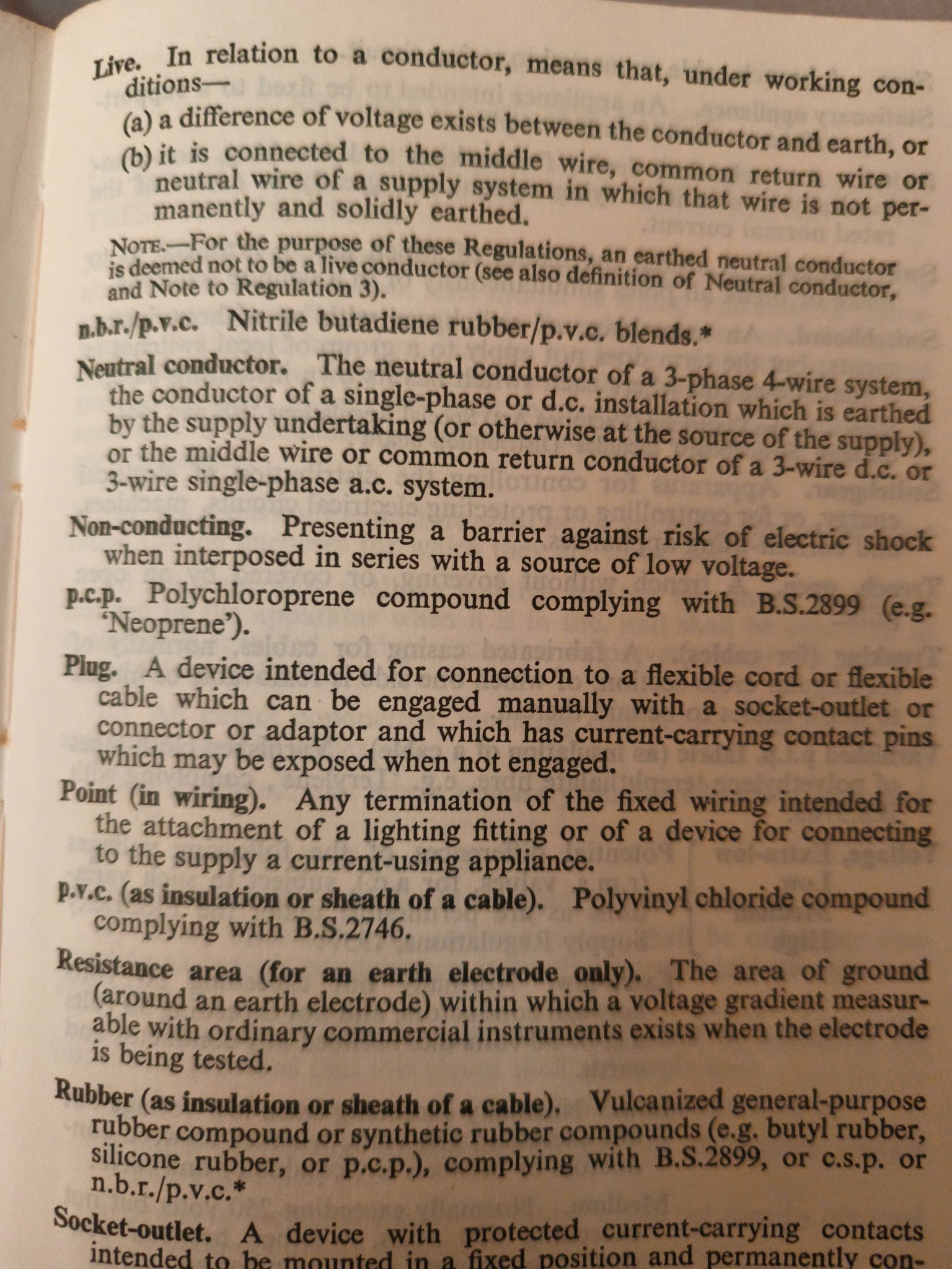

Interesting Regulation of Yesteryear

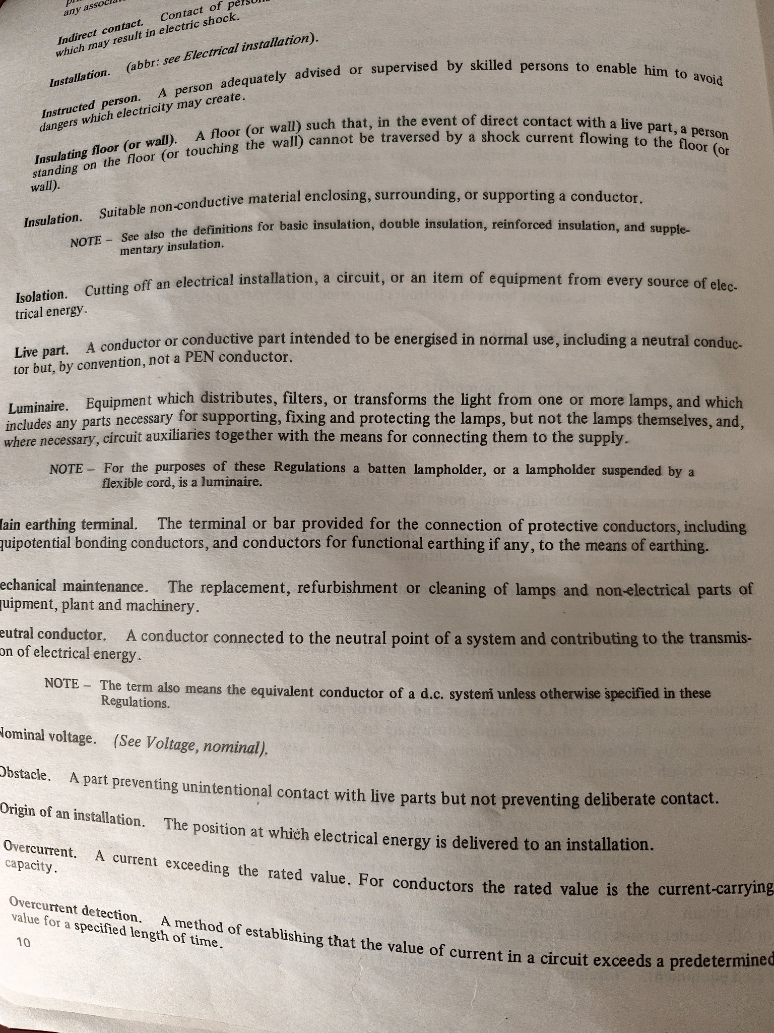

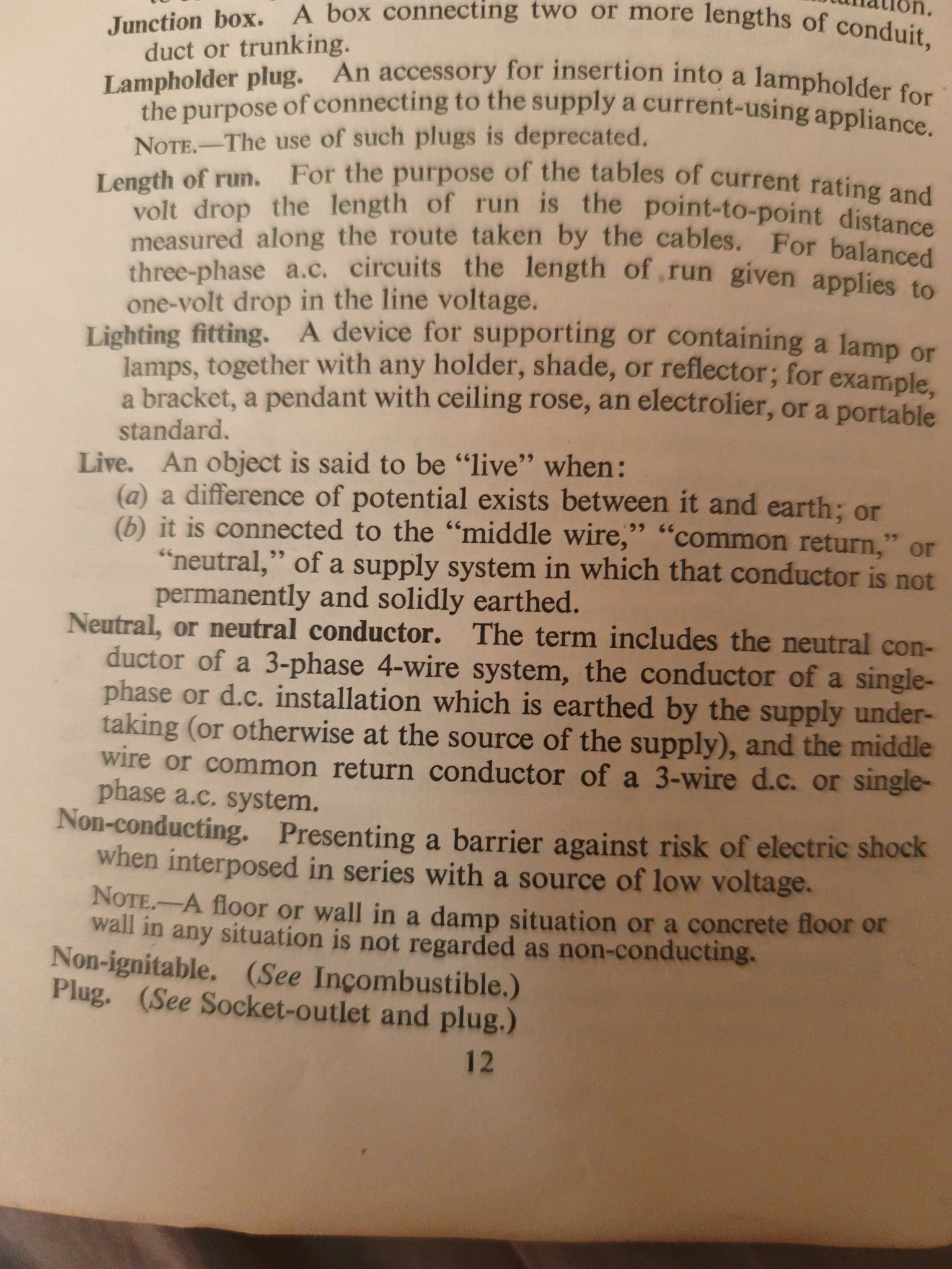

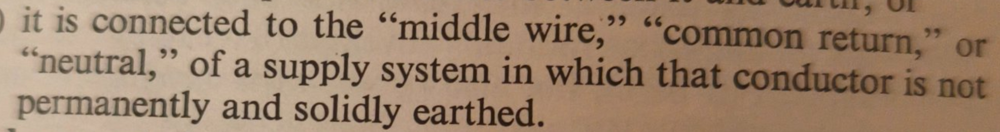

Definition of live from the 13th.

The middle/common/neutral of a TN-S, TN-C-S or TT supply system is permanently and solidly earthed.

Well I suppose there's the one we've all come across as green apprentices: the open neutral in a lighting circuit.
It's neutral, but it's live!
