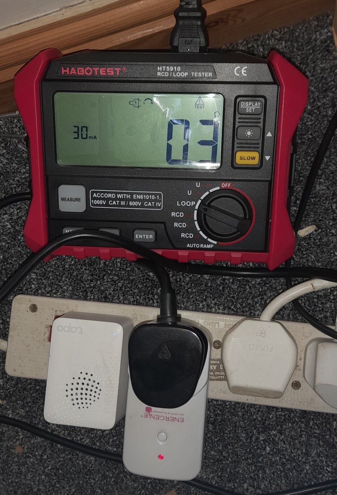

Yes, I have sockets behind furniture. But that does not stop me checking the sockets on the extension lead which I can reach. To plug in tester and press button is easy. Loop-test-socket.jpg I do think this
is not as clear as it could be to show correct polarity, if reversed the curved line with arrow is shown below L and N with arrow reversed. But most socket testers show Line - Neutral reversed 1740009844106.pngeven the cheapest models, but with a FCU to test you need to dismantle something, so it could easily be left that way for years.
