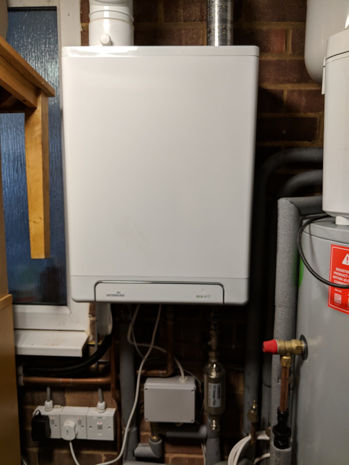

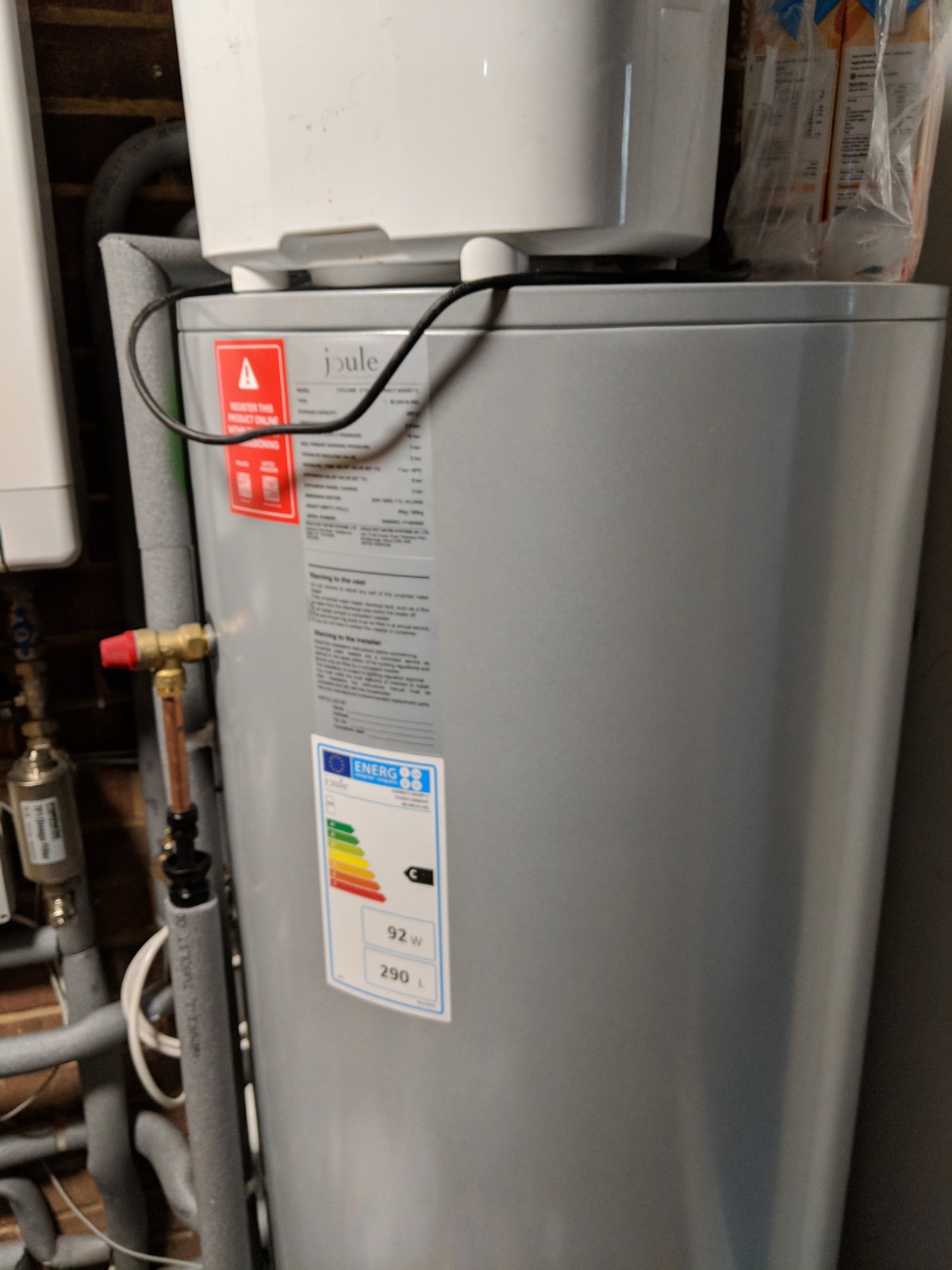

Following on from a previous thread where I had my water supply upgraded here I'd like to share some pictures of the finished install :D
The hardware side is great, oodles of hot water at great pressure and the house is lovely and warm. The only caveat (always has to be at least one :() is that the Intouch app/gateway solution is causing problems whereby on the heating side, the timer/schedule functions are not currently working (for about the last 7 days). I am turning the heating on/off manually using the room thermostat. Currently awaiting a fix from Intergas..hopefully. Failing that, I guess it would make sense to ditch the remote app setup and just have a wireless controller.

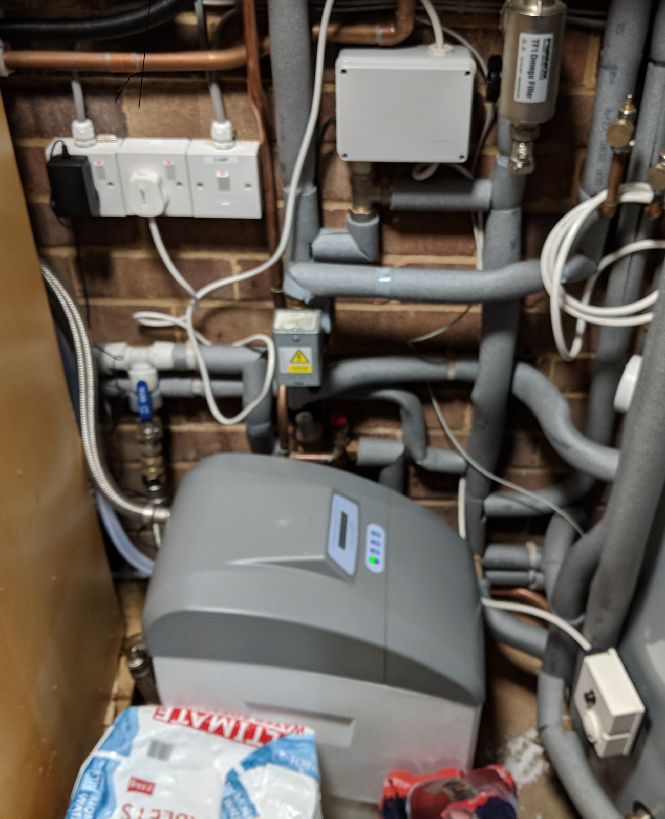

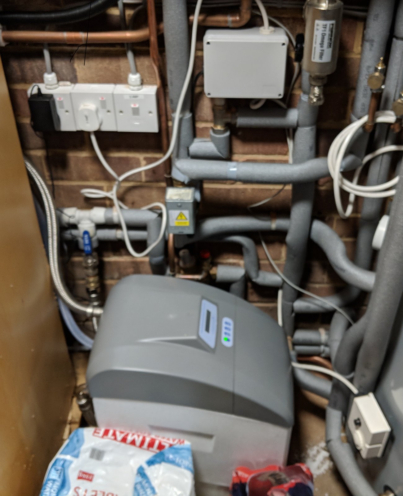

I also had a water softener installed, cant see it very well here but its a Monarch Midi, its also made a big improvement. The next stage is to get a 'proper' second shower fitted and see how it all works with 2 bathrooms concurrently.
