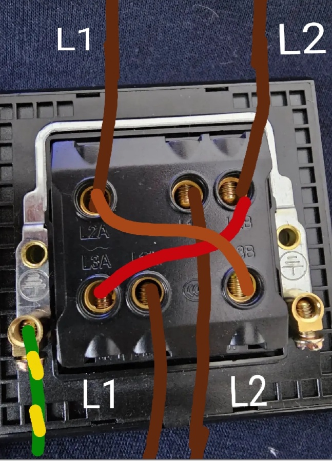

One way would be this...
EDIT:
Photo edited to match labels on OPs existing switch.
(And assuming L1A and L1B are common etc.)
Sorry, it's a bit difficult to draw pictures on a phone...

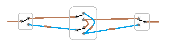

Perhaps a more linear view would make it easier to understand:
Needless to say, I do 'understand' - but I still think that many/most electricians would (without 'instructions') be initially 'thrown' by something sold as an intermediate switch which had 6 terminals.
Many/most are familiar with the fact that an intermediate switch can be wired to produce "two-way" (or "one way") functionality. However, presumably because DPDT switches have not (hitherto) been available, they are unlikley to be familiar with wiring such a switch for use as an intermediate.
Kind Regards, John

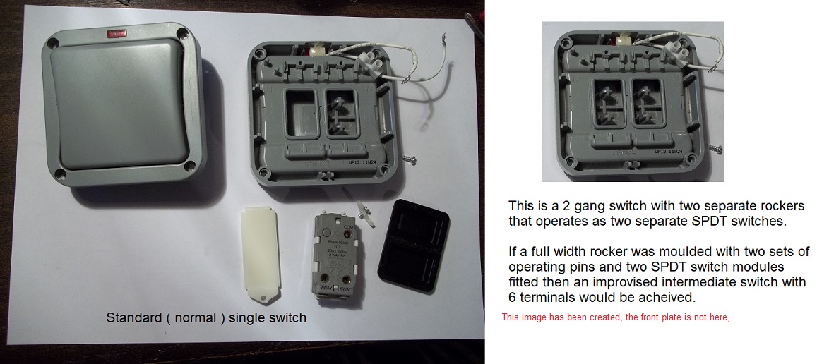

I now recall where I saw a 6 terminal intermediate switch, it was in a factory wet area installation.
Very similar to this simulation I created using photos of a BG water proof switch,
