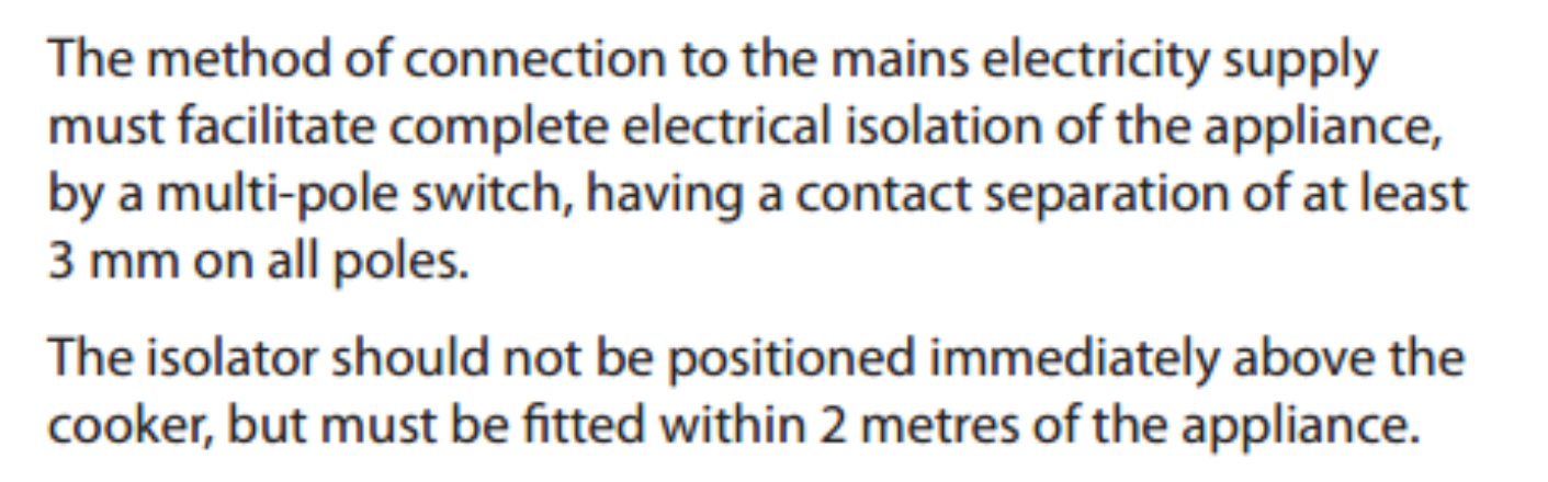

I am starting this thread to avoid hijacking the other thread any further.
Here is an extract from the manufacturers instructions for an aga electric cooker.

“BS 7671 regulation 132.9” said:
An interrupting device shall be installed in such a way that it can easily be recognized and effectively and rapidly operated where, in the case of danger, there is a necessity for immediate interruption of the supply
“BS 7671 regulation 134.1.1 said:
Good workmanship by one or more skilled or instructed persons and proper materials shall be used in the erection of the electrical installation. The installation of electrical equipment shall take account of manufacturers’ instructions
“BS 7671 regulation 510.3” said:
Every item of equipment shall be selected and erected so as to allow compliance with the regulations stated in this chapter and the relevant regulations in other parts of BS 7671 and shall take account of manufacturers’ instructions
I have voted 'no' because you said required.
Your question states 'isolator', 132.9 relates to an 'emergency switch'.
The regulations nowhere require local isolation for any appliance.
I think most people would agree that an emergency switch for a domestic cooker is not required nor really needed.
However, that does not mean I would not fit one for a cooker if only because most people would expect one.
What about the extractor fan whose MIs also state an isolator should be fitted plus a fuse whether necessary or not?
Where do you draw the line for which parts of the MIs you follow, and which parts you ignore?
