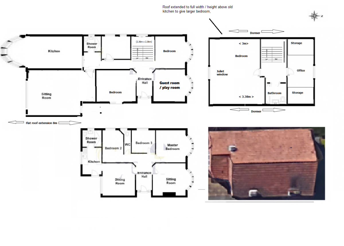

My latest plan .... original house layout below my mad idea. Reasoning - if I do a flat roof, this is possible under permitted development, which means nobody can stop me (other than my bank manager). Two advantages of this: we get a bedroom that overlooks the garden with nice Juliet window (120 foot garden, not over looked at back either). We remove pitched roof above kitchen and flatten, put in 2 dormers (5-6m) each side, leaving just a little of the original roof to replace - the original roof is old, some past woodworm, no felt, generally about time it was replaced. So, the office space will be "Velux" only, but will also have a window to front on gable. Stairs and bathroom will have obscure glass windows.
Might actually reduce the size of the downstairs extension, as this was the plan before doing the loft. Don't need that much space, could easily lose one of those middle rooms.
Surveyor confirmed the house have never been extended, so can go back 8m under PD.

not exactly sure where you are going here
but as long as you realize you cannot use the roof a terrace without planning permission which in general will not be granted in a normal close housing situation[closer than perhaps 200metres]
you also would need to plan on the structural strength and top layer suitable for footfall and extra loading
really, just asking if an 8m flat roof is considered OK? I have read some comments about flat roofs having problems ever time, and this is more likely as they get larger. Also, read about some insurance companies not liking them. Although, others have commented that nothing wrong with big flat roofs these days. Just concerrned that my latest plan might have some major flaws etc. Will obviously have a structural engineer or similar do all the calcs for it, and do it all properly.
in general you have a small fall but the larger the area the more chance deviations will cause pooling off water that will cause problems with damage
also you are correct insurance companies also ask if there are flat roofs over certain percentage of the total roof area . I presume because they lead to higher numbers of claims. that said properly designed and fitted they will be fine.
Depends which way you're facing. It's in the back garden, road is to the right. Easier to plan sideways on my monitor!
Reckon something like this would be more sensible. ... one concern is that the bedroom window will look out mostly onto the roof, so maybe extending the roof back to original rear wall, and making the extension shorter, but having a pretty glazed space for dining in the kitchen, would work better...

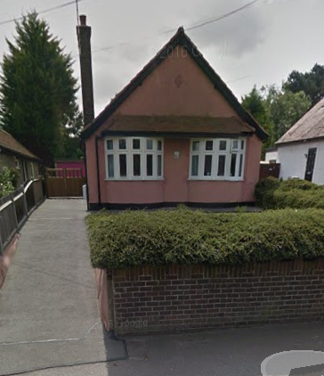

Was joking. Road is to the right, rear to the left.
Hopefully the front! Could it be considered the side? The front has 2 bay windows, but the entrance is on the side.... #confused
That's what you need to be sure of before planning any work under PD.
Impressive stack, btw.
Yeah, it is a tall one, isn't it!
I'll be putting the plans in for the pd cert thing anyway, so let's see what they come back with.
