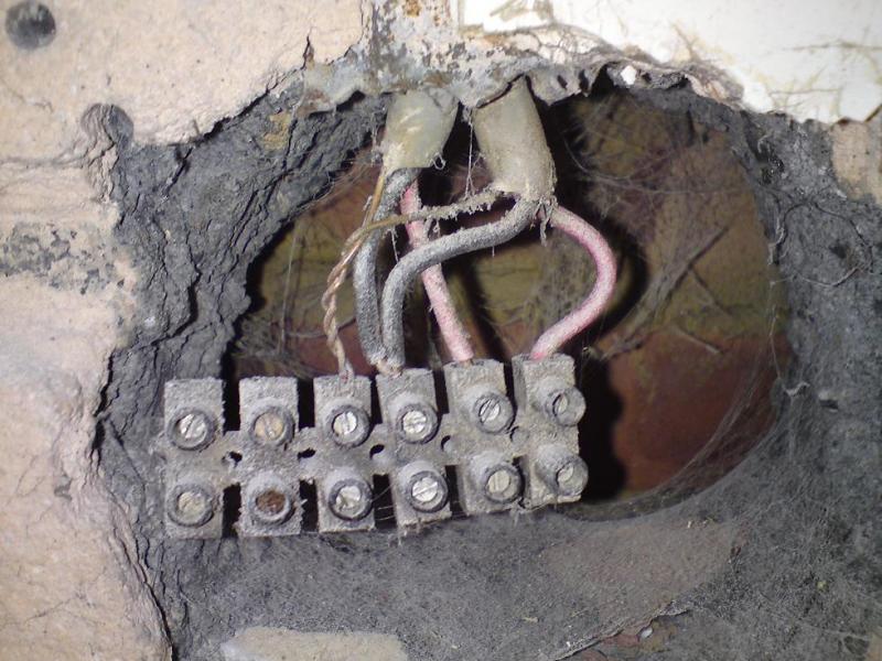

We dissmantled our kitchen a few days ago and found some dodgy connection block which the cooker was wired into.
There appears to be two twin and earth cables in parrallel coming down the wall in the plaster which connect to this block. A double socket was also connected to this block which I have disconnected for the time being.
Both red wires going to the block are live (230ish volts tested with my multi meter).
I have added a pic so you can see what I mean. The neutrals are joined but not the live wires.
How can I work out if these two twin and earth wires are on the same ring and whether the red wires should be joined together?
I plan to turn of the electrics and turn on each circuit one at a time and check with my multi-meter to see if either one or both are live on which breaker. Apart from that what else can I do?

first thing, be careful when playing with electric, especially dodgy wiring as shown. u could be opening a whole can of worms!
to check if they are on same circuit you need to turn the power off at the mains. then set your multimeter to ohms (checks resitance) touch the 2 red wires with the probes, if they are on same circuit you should get a reading. this only says if they are on same circuit, to fully be sure they are on a ring means taking readings at the board, which would require a long step by step walkthru which i wouldnt advise here.
I can see a bit of a flaw in that test if you meant turning off the main isolator for the CU. You would see continuity between two circuits connected to two different fuses/breakers.
Similar technique to above. With the supply isolated, and the fuse removed or MCB for the circuit turned off, first check there's no voltage on any of the conductors, (I was taught always to start by testing for mains voltage, to save frying your meter if something else unexpected is going on) then check for continuity between the two reds. If you see continuity, it is likely to be a ring.
If there is no continuity, test again with the fuses replaced / MCBs on, but the supply still isolated. You should then see continuity through the fuses/mcbs of the circuits.
If there is still no continuity, you may have a spur off a spur, a broken radial circuit or some other non-standard arrangement.

I can do those tests pretty easily in a bit. If the two twin and earth cables are part of the downstairs ring and the two lives are not connected together what problems does this cause?

One problem is ring circuits are fault tolerant, and will carry on working without any apparent signs of distress even if there are faults present that would stop other designs of circuit from working and prompt investigation and repair.
If a ring is split, accidentally or otherwise, then you have two radial circuits fed from one over-rated protective device. If you end up with the full load carried by just one radial, it may lead to overheating and a possible fire hazard amongst other things.
Ok, I have run some tests. The results are as follows.
I have tested the live wire of each of the two cables with a multi meter after turning on each breaker and then turning off again.
Both of the the live wires show 230ish volts when a single 32amp breaker is the only breaker in the on position. I think this proves they are on the same circuit.
I have also turned off all breakers and the main box to the off position and then used the multimeter on both red wires. This changes the ohms value from 1 to 00.1, 001 or 000 depending on which of the 5 ohm settings i set the meter to.
Is this enough to prove that both are on the same ring and the red wires should be joined together?

Does your meter have an audible continuity setting? It might be marked with a musical note. Use this. If you get a sound, you can connect them.

I have set the multi meter on the continuity setting, turned off all the breakers on the CU and set the CU to the off position.
The multi-meter has sounded an audible continious sound when hooked to both live wires.
Can I connect the two live wires now or should I test something else?
Andy
Yes, connect them together and never darken our doorway again.

By the way you cannot simply shove them back into that hole without any warning that they are there. Cables must follow safe zones, which are marked out by electrical accessories being present on the wall.
how should I handle this then? Should i put a blanking box in containing the connection so that people know there is a junction there?
