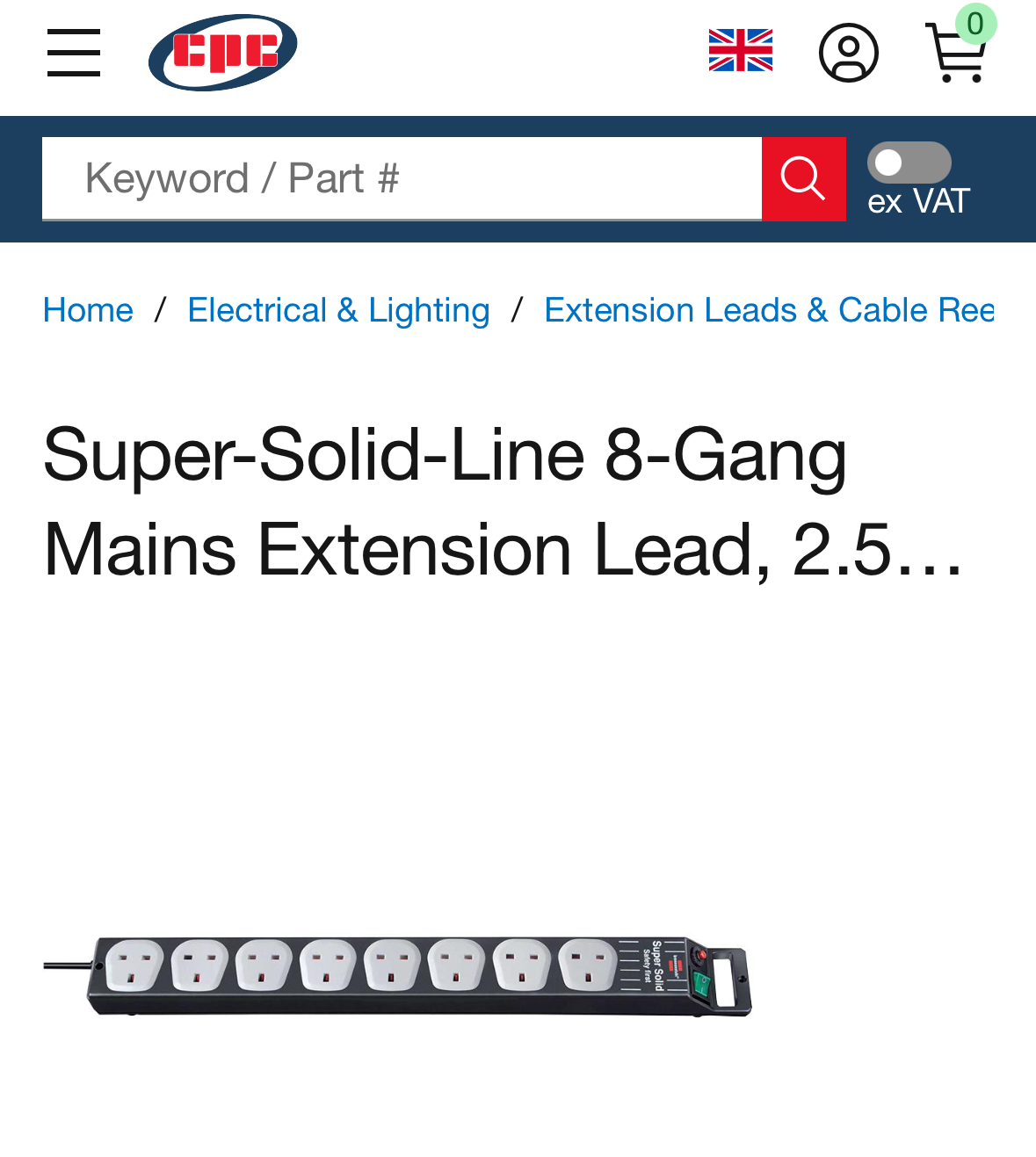

However, I don't see that anyone could/would describe an N-way 'extension lead' which plugged into a 13A socket as being, per se, 'part of the installation', and I suspect that many (most?) would say that that remains the case even if the socket outlets at the end of the extension lead are 'attached' to a wall/whatever.. As has happened in this thread, someone is therefore bound to point out that the two situations are electrically identical, rendering it difficult to produce a consistent 'rule' regarding what is. or is not, 'part of the installation' in these situations.
A four way, 2m extension lead bar (like you’d buy on Amazon for a tenner) is screwed to a wall (in such a way that the screw would have to be removed to take it away) and plugged into a regular socket
A plug with some t&e running to a double socket screwed to a plastic back box, with more t&e running to another double socket and back box, and plugged into a regular socket, but the whole thing is just loose on a bench, not fixed to anything, and could be unplugged and taken away with no visible evidence it had ever been there
Which of these, if any, would we say is “part of the installation”?
Interested to know opinions on whether it’s “what the thing is” vs “how it is incorporated” - whether one, both or neither of these things has an effect
