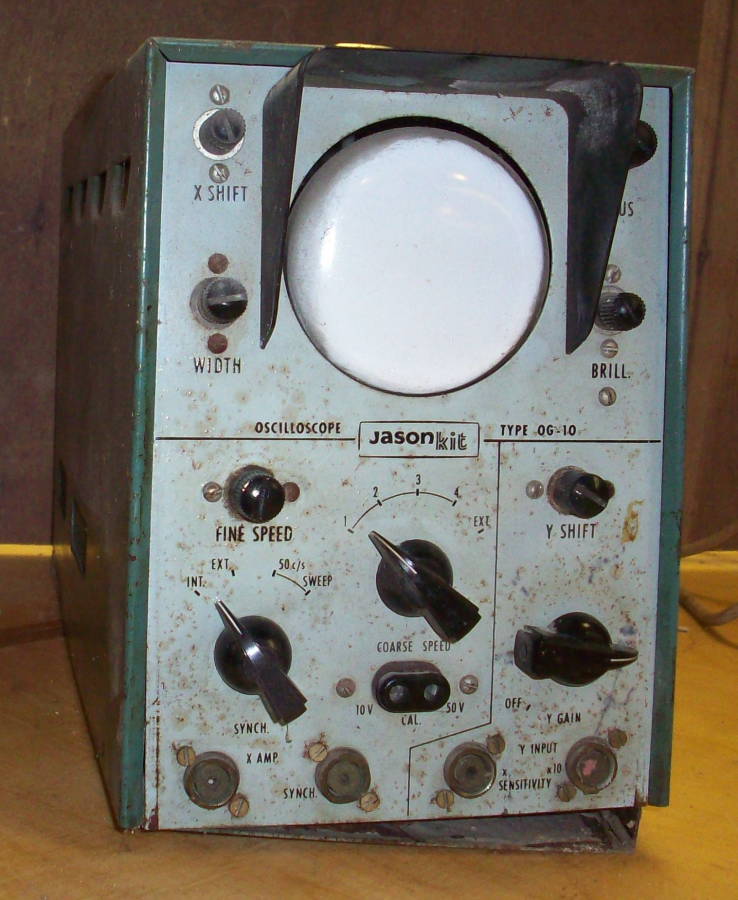

My first oscilloscope was a Gold Advance, a 10Mhz oscilloscope I bought in 1975
Ah. My first one was a Heathkit one (although, for some reason labelled as "Jason kit"), bought (and constructed) around 1963/4. I still have it (along with much more modern alternatives), and it still worked when I last tried it - albeit now rather dusty/rusty! ....

Good lord, that is memorabilia piece, I do remember Heathkit, along with things like world's first micro miniature radio, it was called Sinclair Micromatic, didn't have a speaker and used earphone piece. I used to buy Practical Electronics, Everyday Electronics, Practical Wireless, Wireless World, Elector, every month.
