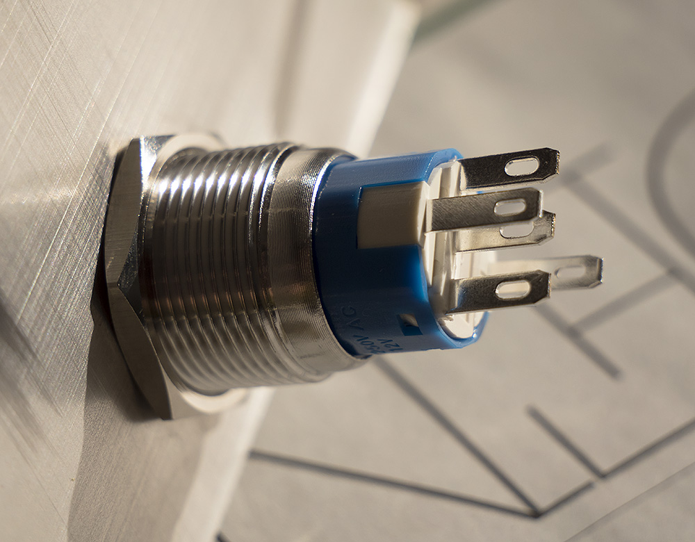

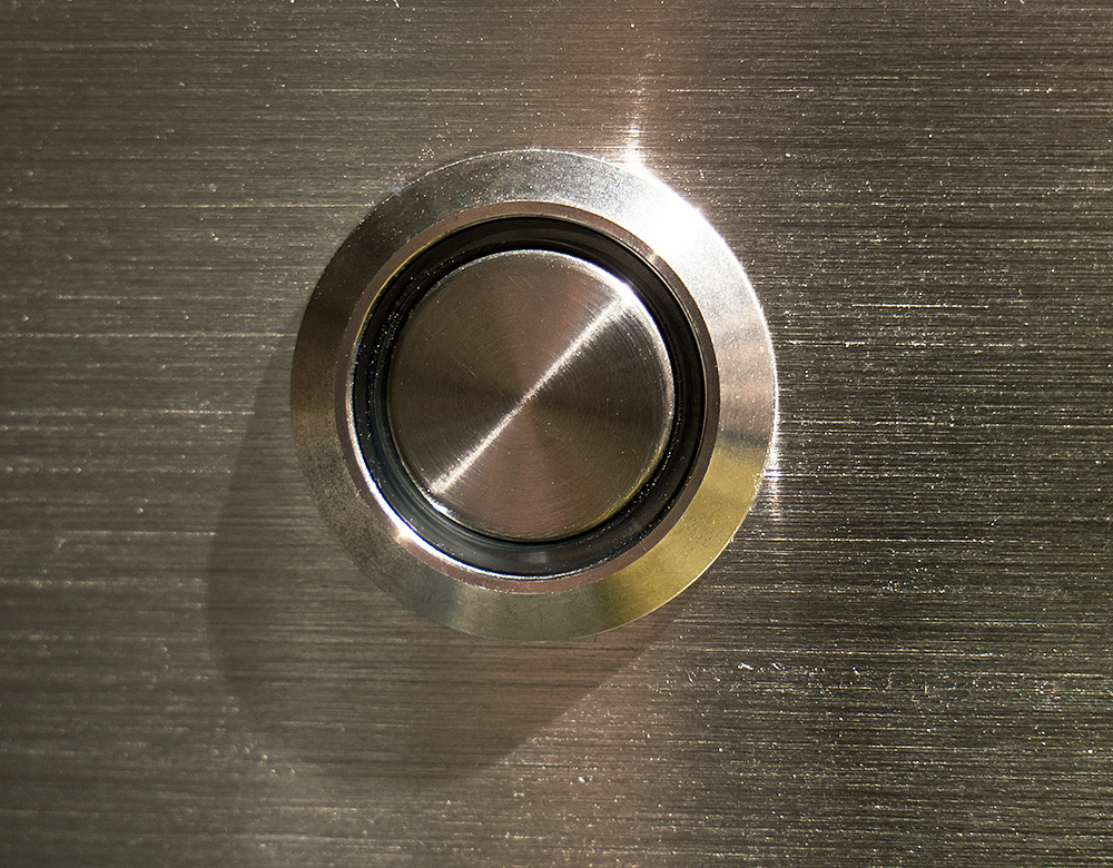

. The supplier's website claimed it was a Bulgin part but when I sent my photos to Bulgin for confirmation they told me it was not one of theirs.
Looks like the push buttons I'm ordering dozens of so I can make my own light switches they are compatible with home automation dimmer modules. Search eBay for "momentary 16mm" or "momentary 18mm" and you'll turn up scores of similar and same looking things. Probably chinese
