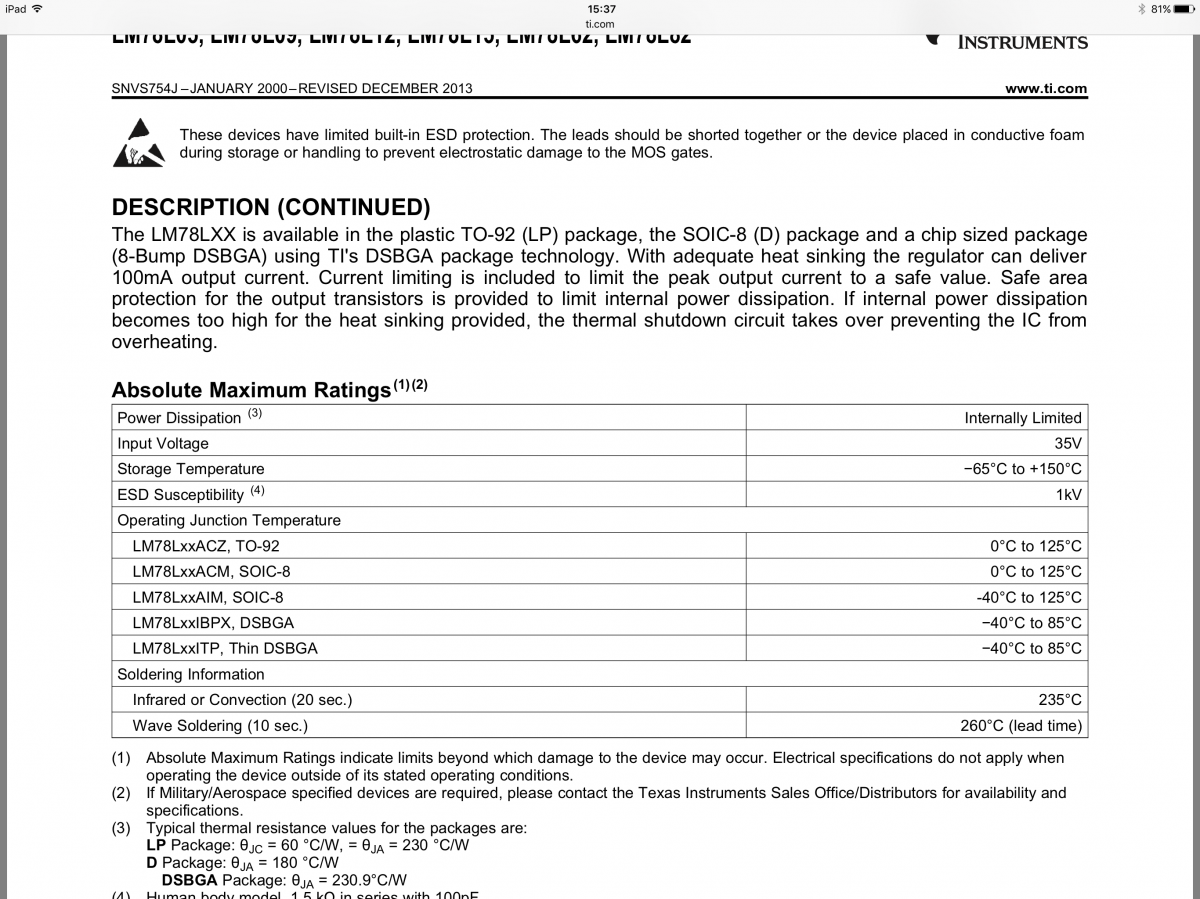

save me writing here, Read warnings on that data Sheet at No 1 towards the bottom of the page, which means those ratings are only valid if the regulator is used properly, with some sort of heat sink, often thick and wider copper track areas of a printed circuit board. free flow of air around the device, but also at the same time avoiding in supply of fresh oxygenated air, hence device enclosed in box big enough to circulate internal air, yet stop more oxygen entering the box if should the device burst into flames, built in current fold back or limiting peak currents can make the device really hot, and if this heat is not dissipated away, the device will become even more hotter, unless heat sinks are used, and if not the device's current limit system will fail due to thermal run away, and the device will go pop or catch fire.
The fact is John, nobody has ever used a voltage regulator to drive just one LED, I haven't come across any gadget or contraption where anyone other than the endocopt using a voltage regulator to drive an LED. It is not industry standard, its like saying I can put a F1 tyre on my family car, of course it will work, but it will also look stupid and cost a lot more and then there will be other implications, you won't be able to go past the first police car that sees you, and you may have brand new sleek F1 tyre but the police will charge you for a bald tyre with no threads! :LOL::LOL:
The 78Lxx regulators made by Texas Instruments have internal thermal protection
Current limiting is included to limit the peak output current to a safe value. Safe area protection for the output transistors is provided to limit internal power dissipation. If internal power dissipation becomes too high for the heat sinking provided, the thermal shutdown circuit takes over preventing the IC from overheating.
