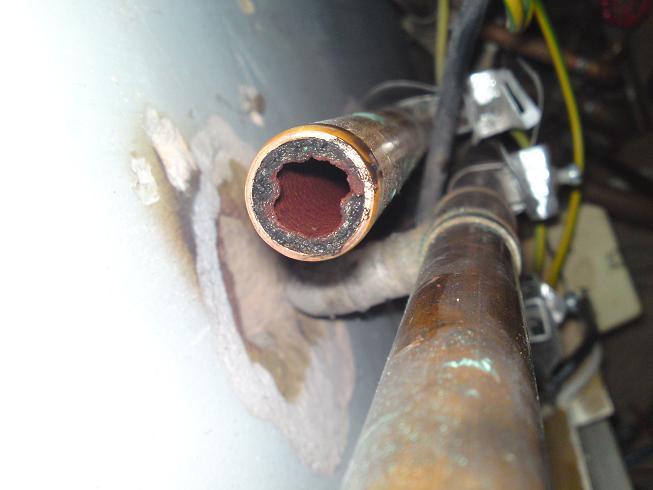

Power flushing a system if i am going to replace the boiler and rads....Also there will be a Magnaclean fitted to the system
lee
Only worth it if it needs it. Is the system very dirty, cold spots in rads long heat up time , dadly designed system etc etc.
If your system was originally fitted correctly with inhibitor added over the years and everything works as it should then there is a very high chance it wont need it
As far as i know the system was put in when the house was built (Aprox 15-17yrs ago)..Yes there are some of the rads that dont heat up at all....
Might just get it flushed before we invest in new boiler and rads... :D
i took it with a camera. This system had the open vent and cold feed the wrong way round for about 23 yrs :!: oopsy. This was the pipe coming up to where the vent and feed were teed in before going to the pump. I managed to cut it further down where it was "better"
