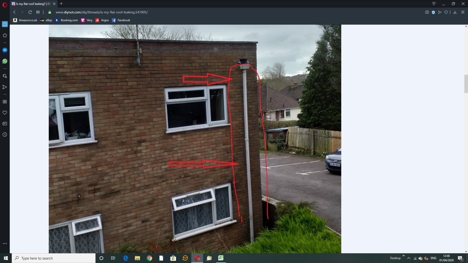

Looking at the outside picture and the state of the corner wet brickwork I would say the outlet is indeed the issue

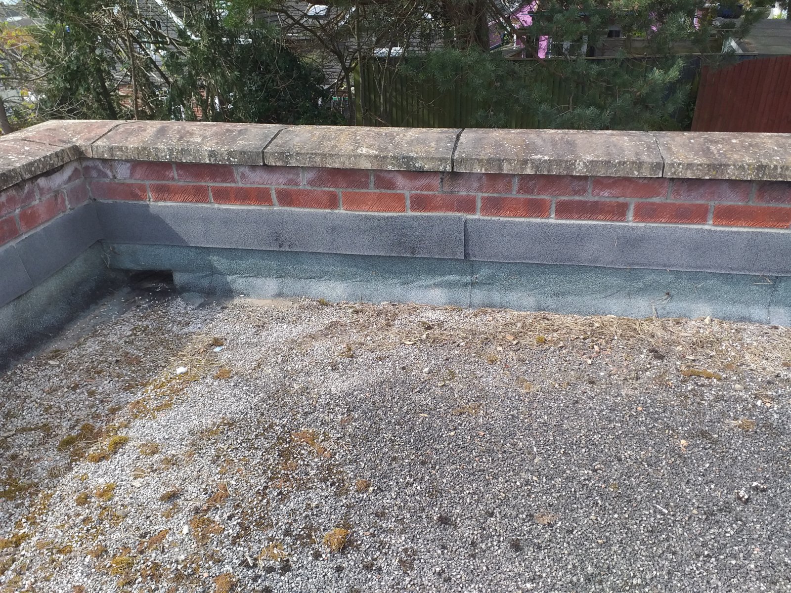

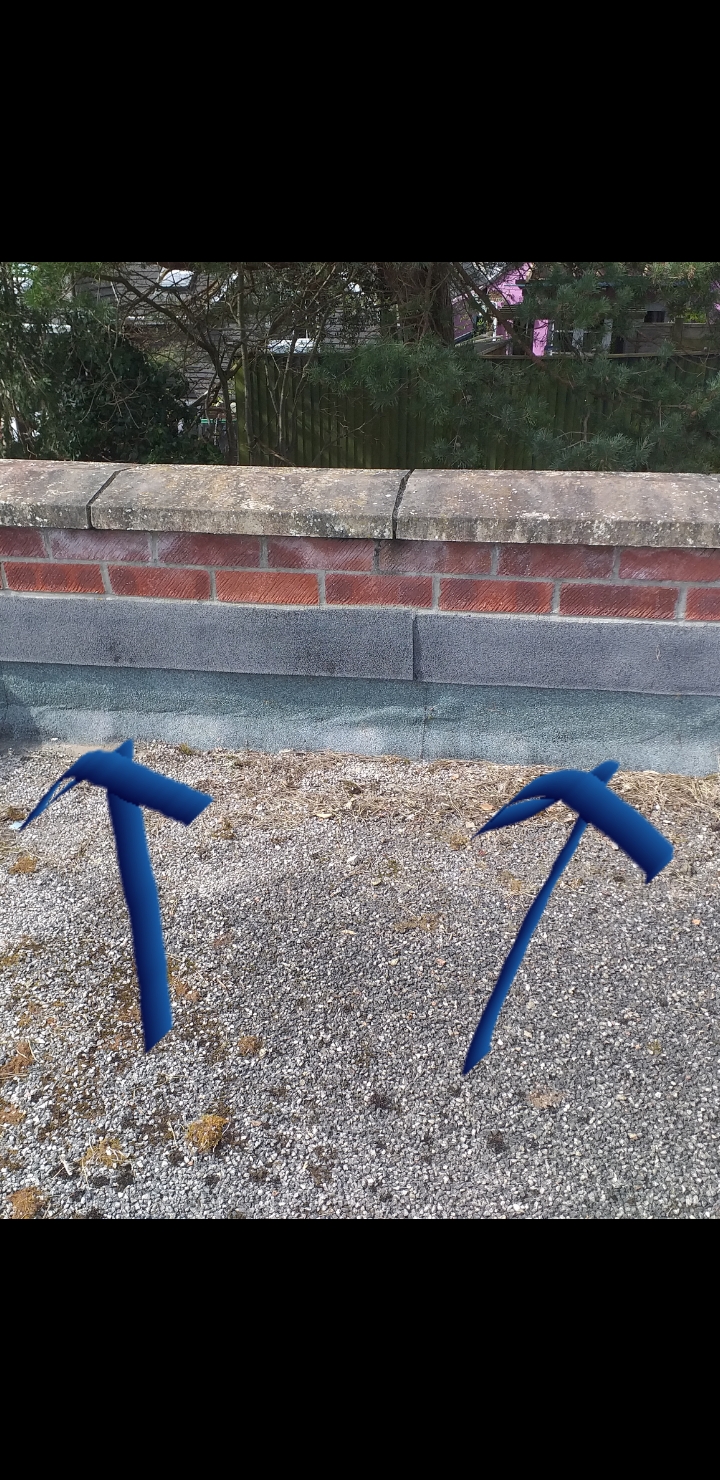

Is the parapet you're on about where arrows point to on the photo?
Its impossible to say from the pictures.
Certainly there has been parapet works in the past.
The top two courses do not look original and the flashing definitely is not
A close up of the outer edge showing top four brick courses would be useful.
The picture I have shown makes me think the outlet is the issue, maybe even as simple as the hopper blocked. The brickwork appears very damp.

I'll get up there and take photos. I guess the parapet is the wall on the edge of the roof?

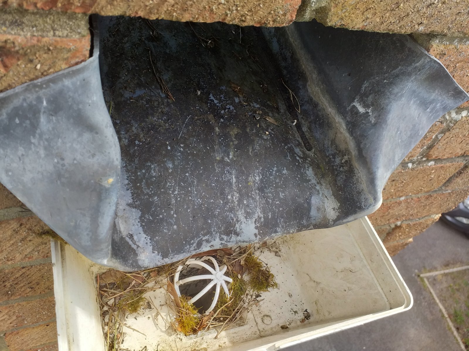

Check the lead at the outlet is protruding into the hopper far enough and not rotted away.
Put a hose down the hopper and make sure the pipe is clear.
Top 2 courses look like new as well as the presence of a tray.
I put a hose in the top and it was running all the way down to the drain at the bottom. I didn't run it for a long time to see if the drain filled up but obviously the downpipe isn't totally blocked
Ok trays in the parapet so not coming from up top
pictures of the outlet says it all.. Looks pretty shot
Get a good felt roofing specialist to take a look
Check the lead works on the outer edge of the outlet too There is a dodgy detail each side

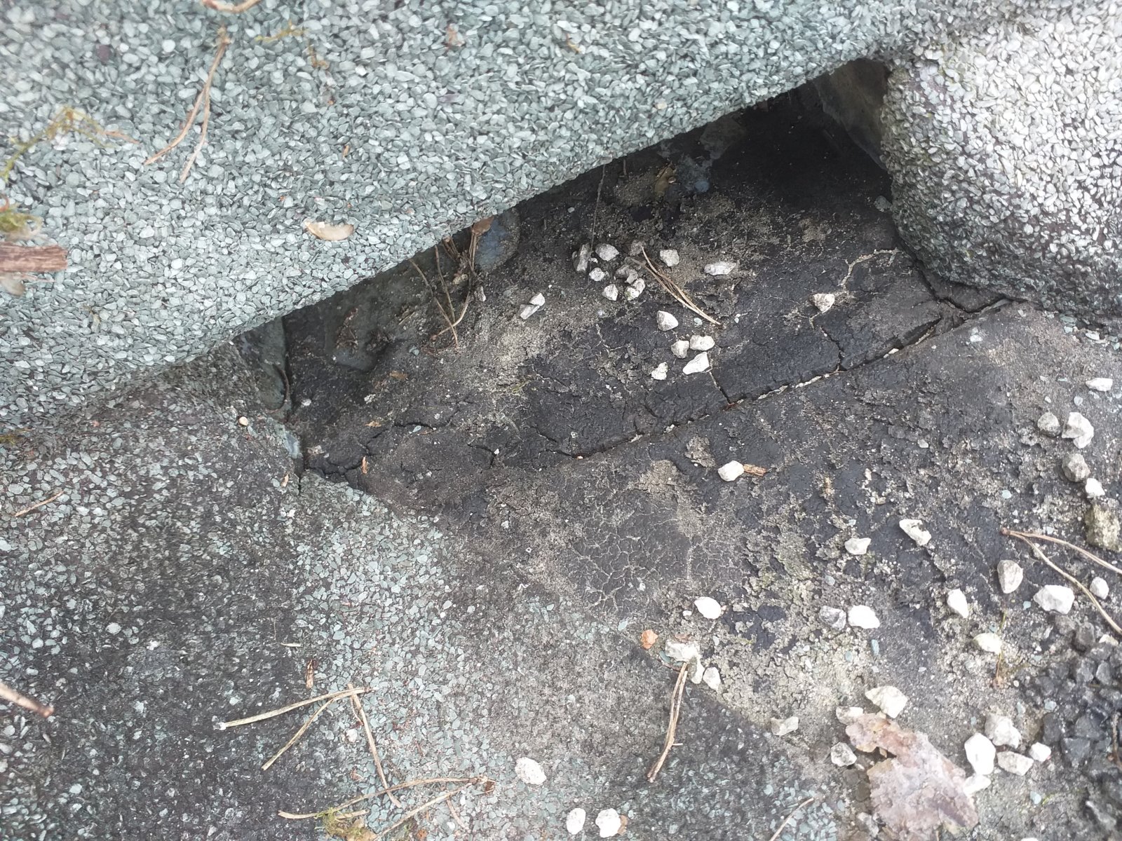

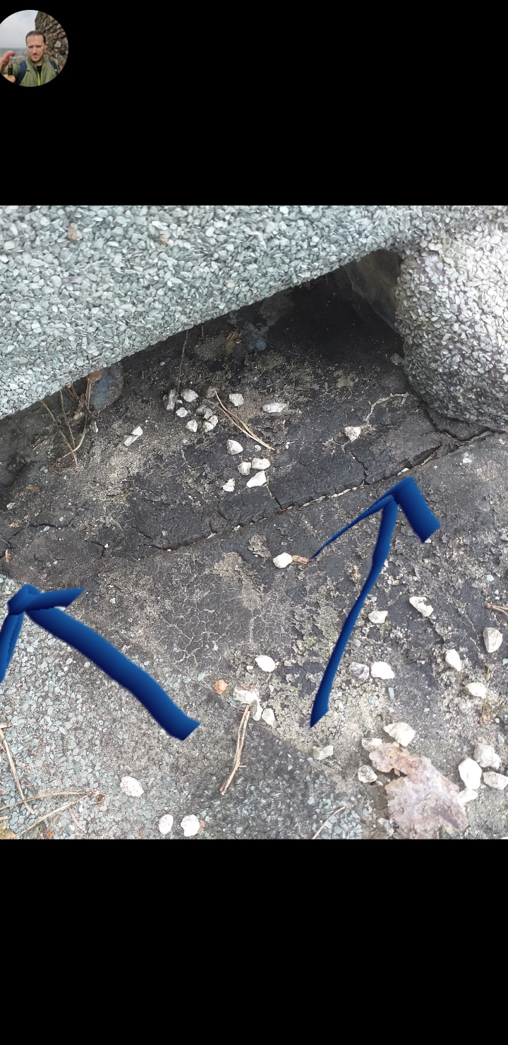

Do you think it's the cracks where arrows are and possibly also where the wall joins the roof (in other picture)?
Would you say a repair in that area is enough if I can't see any other cracks elsewhere?
