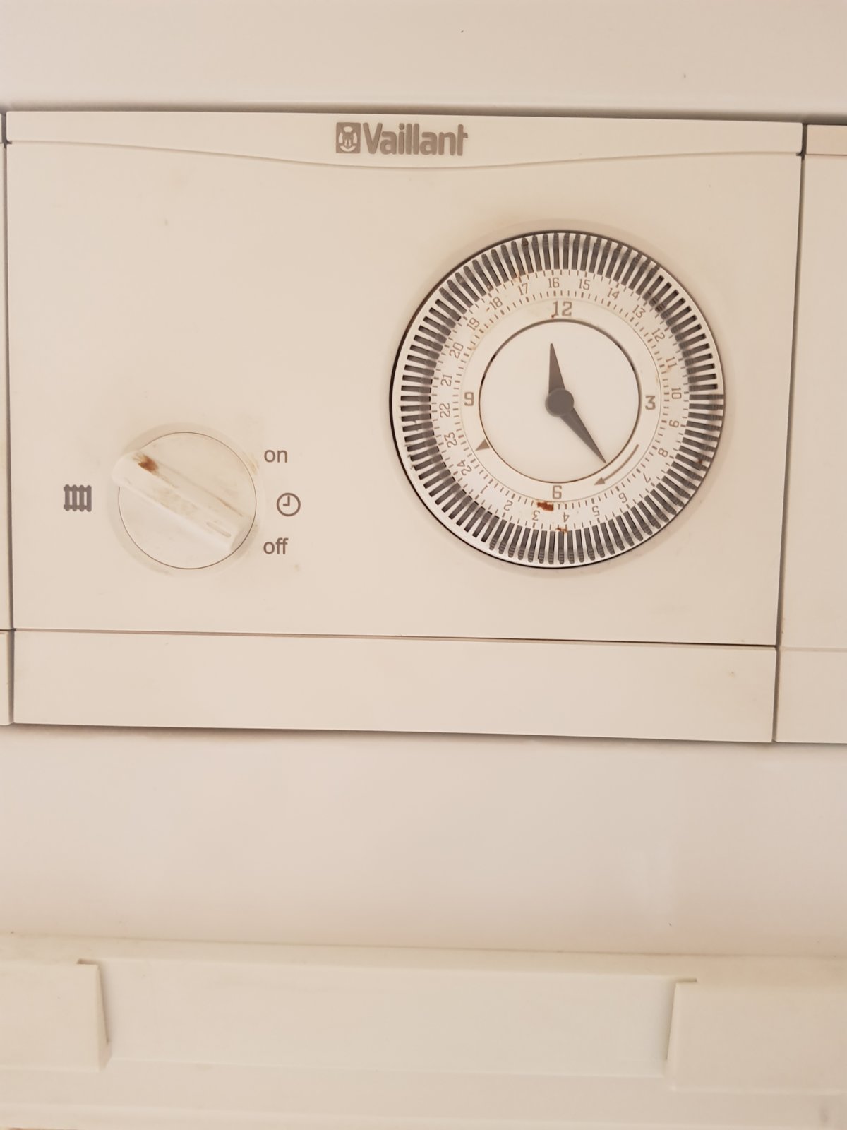

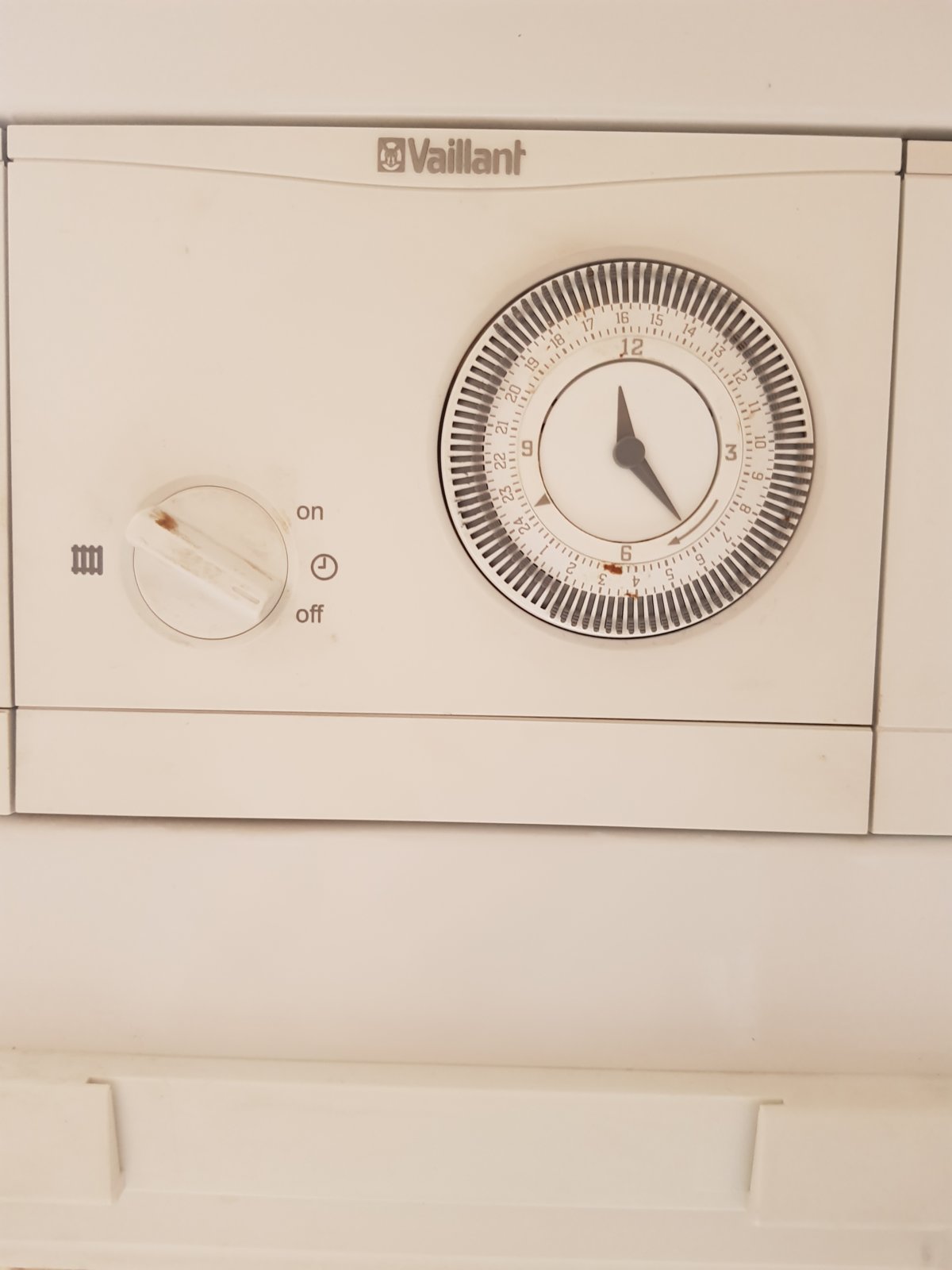

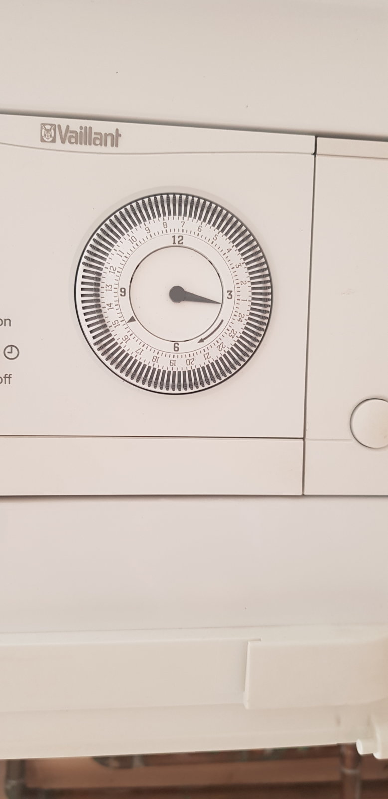

It's this one 150 timeswitch

Yes the clock is more or less lined up proper, although the hour hand which is painted on the dial , doesn't line up exactly, ie 9pm...the minute hand will be at 12 and the hour hand just below the 9...but more importantly if I set the boiler to come on say 8pm to 12pm..it doesn't switch on at 8pm, could be well after 8 or even before..anyway got a new one from eBay coming so will see how that works

If that pic is yours:
Time noted when you posted pic - 11:23 am, time set on that time switch around 00:23, I would say your clock is set wrong. Turn the clock to the correct time in the direction of the arrow and try that, if it still messes the time up then needs replacing. You also have it set to come on at 19:00 until 02:00 and 10:00 - 13:00

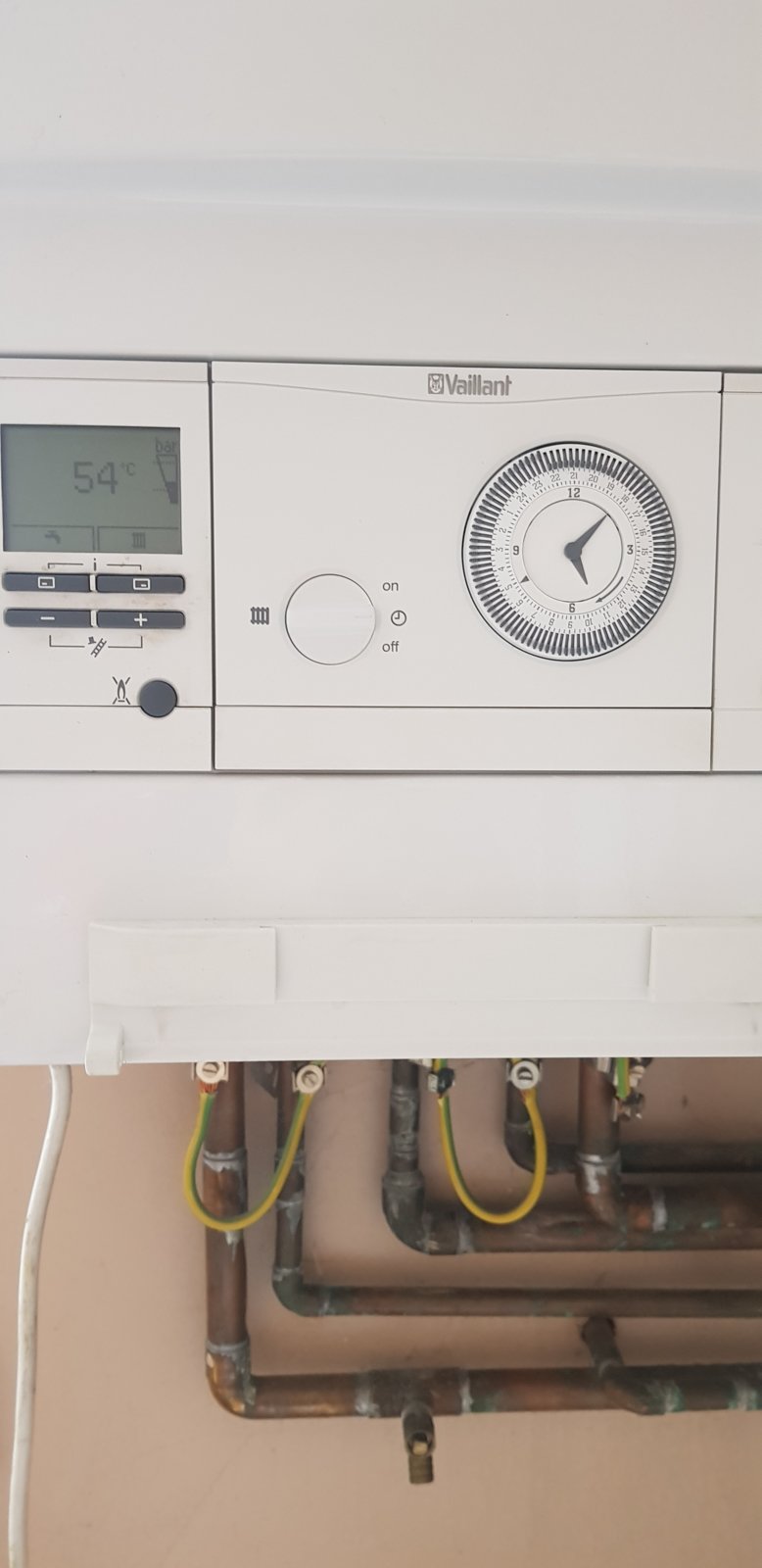

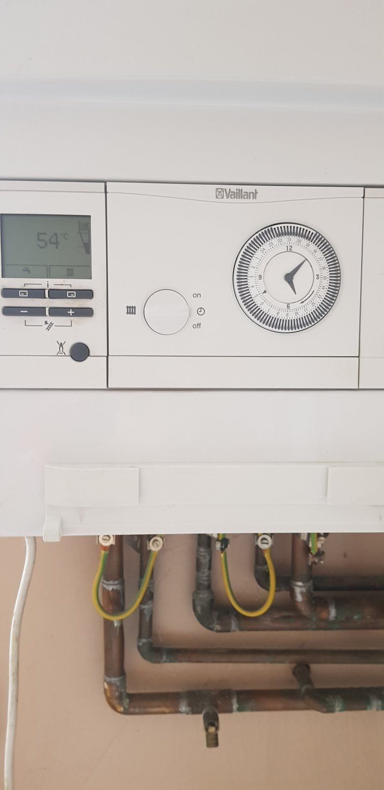

Ok guys just an update..I bought a new timeswitch 150..straight forward to fit...how come the boiler won't switch on when on timer mode,?...I set it come on from 1pm to 3pm by pushing the pins in..,but it fails to come on...any ideas?..20190528_151900.jpg

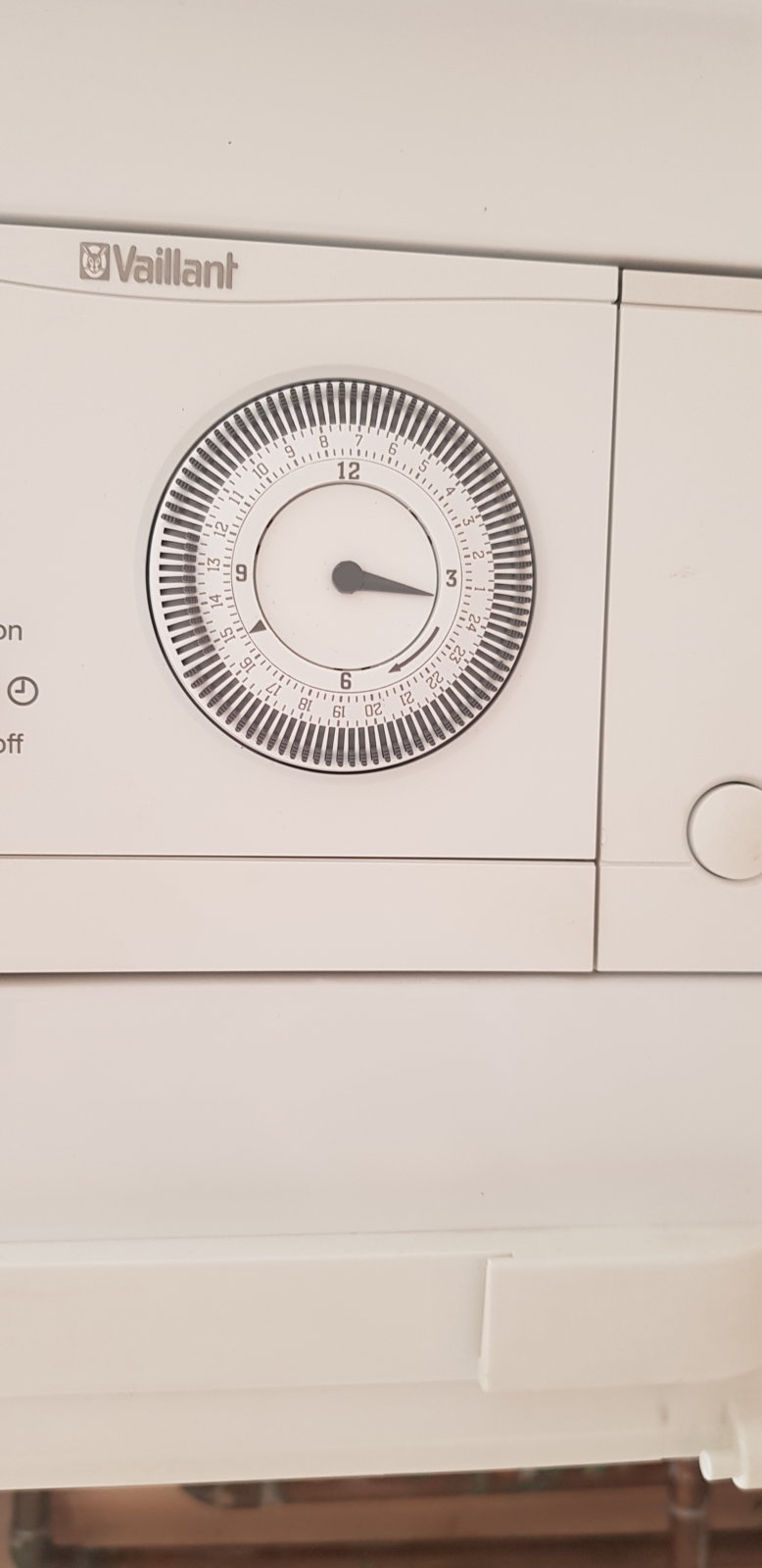

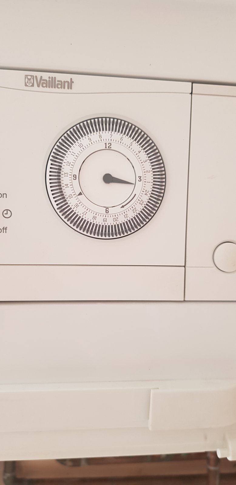

Sorry just read above post ...what do mean my time is set wrong?..is it correct in this pic?
Ok guys just an update..I bought a new timeswitch 150..straight forward to fit...how come the boiler won't switch on when on timer mode,?...I set it come on from 1pm to 3pm by pushing the pins in..,but it fails to come on...any ideas?..View attachment 165076
It looks like it is. Is you roomstat turned up? Is the heating dial up on boiler?
Time on first pic, it wasn’t set to correct time, so wouldn’t come on at correct time. The little triangle denotes where the time should be.
I don't have a room thermostat, yes the dial is set to timer..
Ahhh ok..didn't know about the little triangle..lol
