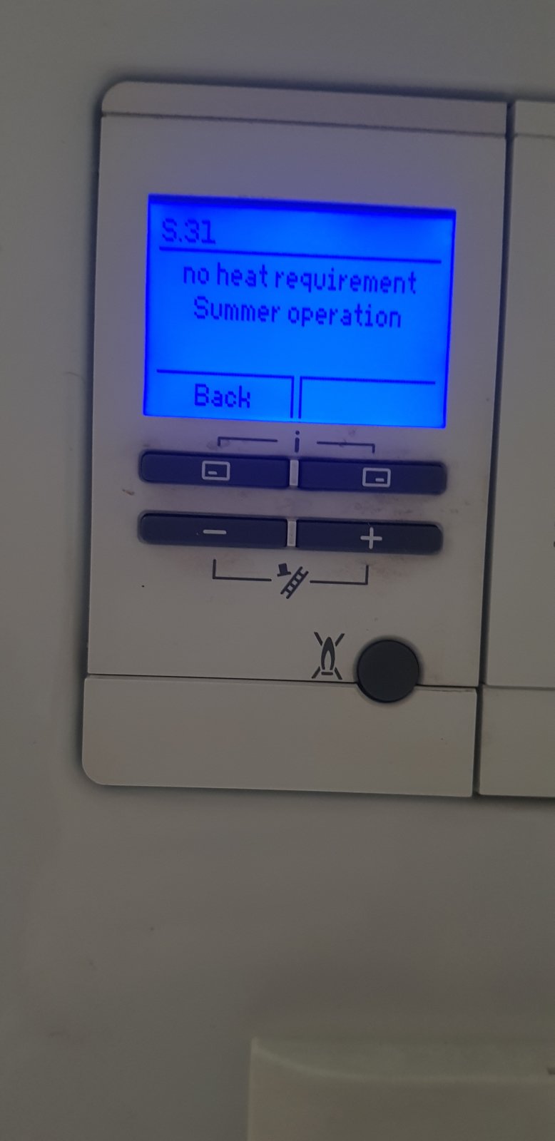

Is my timeswitch faulty?
I don't have a room thermostat

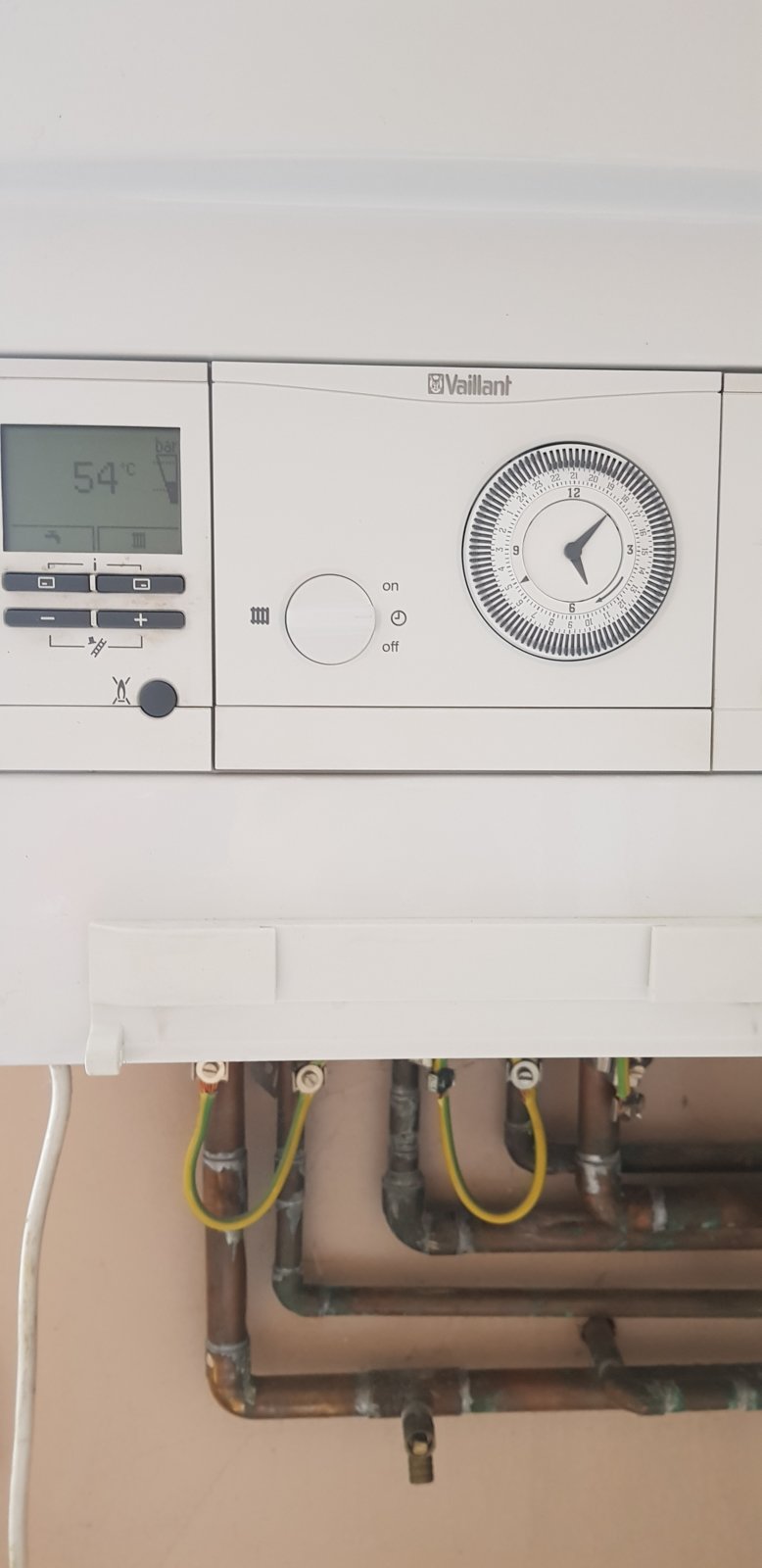

How do you control your heating temperature, via the boiler? Press the top 2 buttons at the same time, will need to do it twice (first time wakes it up). If it has S.30 you have a room stat.
Yes via the boiler. I don't have a room stat..I control the heating via the timer on the boiler..I have nothing else..I prefer this way..
So because you have no room thermostat, your boiler stat maybe at temperature.
Yes , some menu came up, pressure, installers menu, etc..nothing I saw about s30?
You have to press them both at the same time, it should give you the status of the boiler. If it’s not your time switch, and you have no room stat then I’d be looking towards your boiler temperature setting. What happens when you remove the timeswitch, does the heating come on?

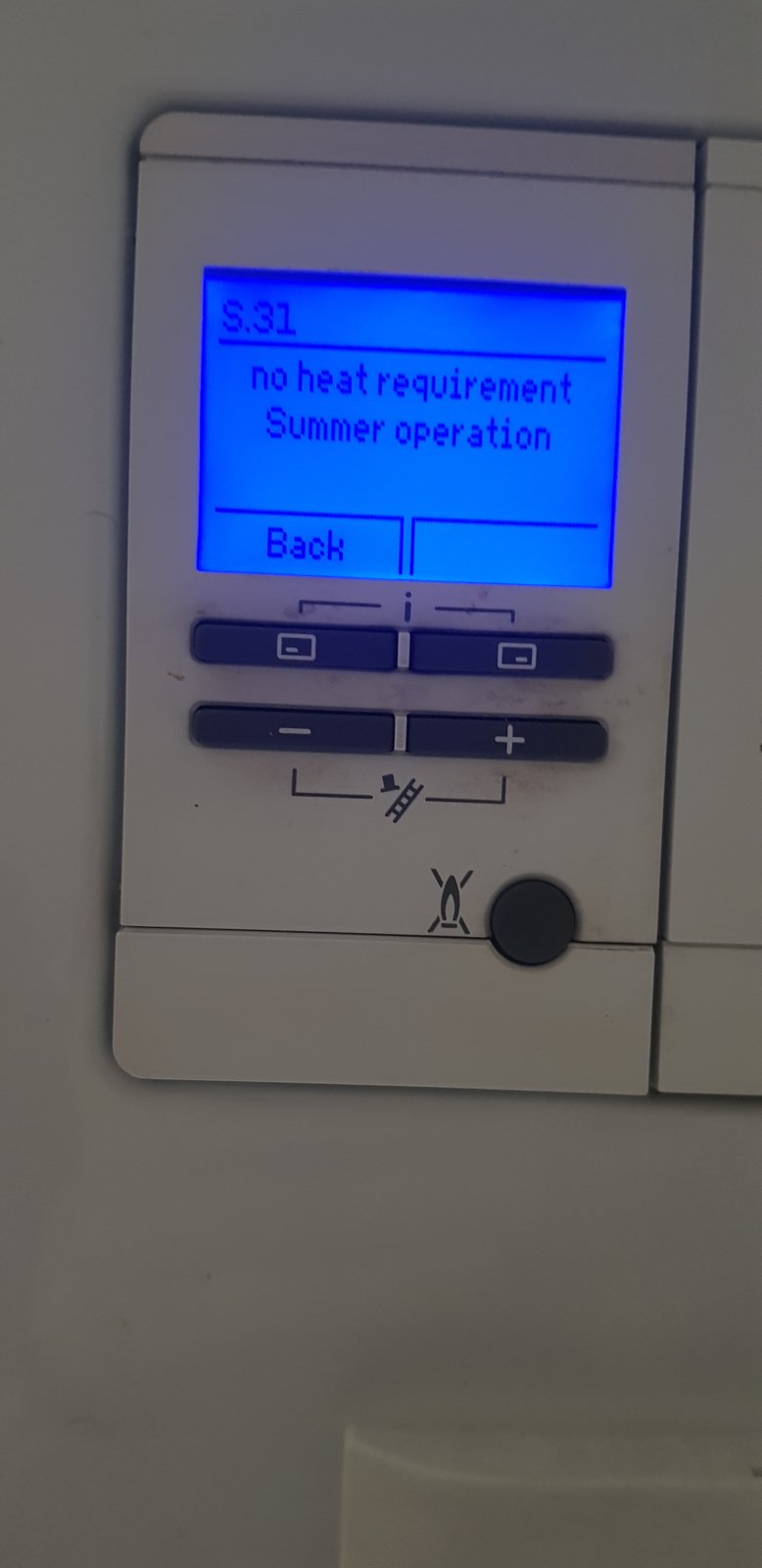

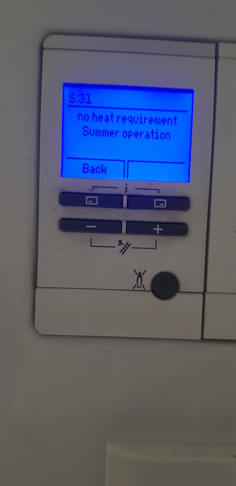

Yes i did press them together, I get see pic..I havnt tried removing the switch to see if heating comes on..is it suppose to or not? 20190529_190444.jpg
Yes i did press them together, I get see pic..I havnt tried removing the switch to see if heating comes on..is it suppose to or not? View attachment 165131
It should come on if you remove the timeswitch, but in that pic if you look in the top left you have s.31, and states summer operation. Try the boiler temperature press the button on top right when back to normal mode, see what temp set to, if it’s to set temp, then it will not come on.
