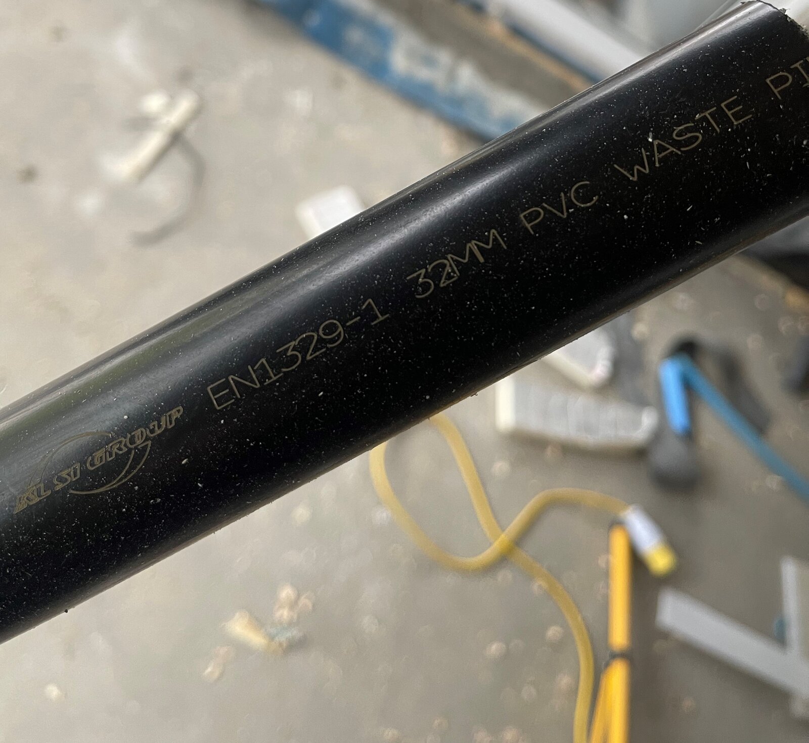

My plumber has laid PVC 32mm solvent weld waste pipe ready for the pressure and temperature relief drainage for a new 90l unvented indirect cylinder.
Is this ok? I thought metal was recommended but he says it is high temp waste pipe.
Will it cause me problems on an annual inspection?
Here's a pic of the pipe label.
Thanks for any advice!
MuPVC or PVC-C are acceptable, as is Polypropylene push-fit, but the standard PVC you have there is not. Is your installer G3 Registered, as is required to fit an unvented cylinder?
