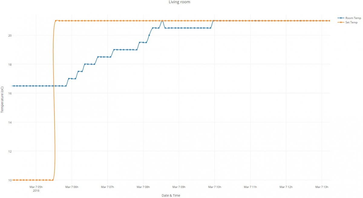

I'm intrigued by the way the room temperature goes up in steps. The 'treads' are where the boiler goes off for a short while.This could be caused by the thermostat (make and model would help), or by the boiler short cycling (same info please). Eliminating these steps, so the room temperature increased continuously, would reduce considerably the room's heat up time.The following graph shows how the set temp (red trace) and actual room temp (blue trace) changed over the last 24h:
Is the radiator sufficient for the room size?
As for your question, the fact that the room reaches the desired temperature suggests that the rad is large enough.

Are you saying that you can only measure the temperature to the nearest 0.5C?I think the steps are just a product of the fact I have the graphing software set up to "poll" the temperature every 5 mins, hence it is showing as steps. It's just that it's taking more than 5 mins to increase the room temp by half a degree.
Do you know if the boiler is cycling?
What thermostat do you have?

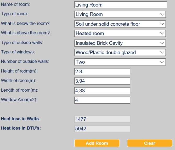

Here's a heat loss analysis I've just done on the City Plumbing website:
It's suggesting 5042 BTU/hr, or 1.48kW. I honestly have no idea what the radiator is rated at, can't see a manufacturer on it anywhere. But most 1500 x 300mm rads I've found online are around 5100 BTU.

You are missing the point. The OP is not sitting up each morning reading the temperature from the thermostat every five minutes. He has a Raspbery Pi, presumably with a k-type temperature sensor attached, to automatically record the temperature every five minutes. The sensor should be able to measure the temperature to an accuracy of 0.1C. Incidentally digital room stats may display temperatures in 0.5C steps, but they can measure to a greater degree of accuracy.heating controls, even digi ones will always have a temperature hiatus. Measuring down to .5degC is just plain daft.
