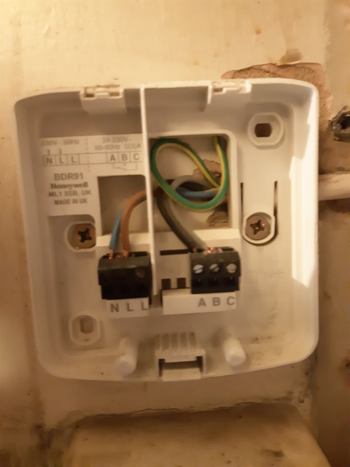

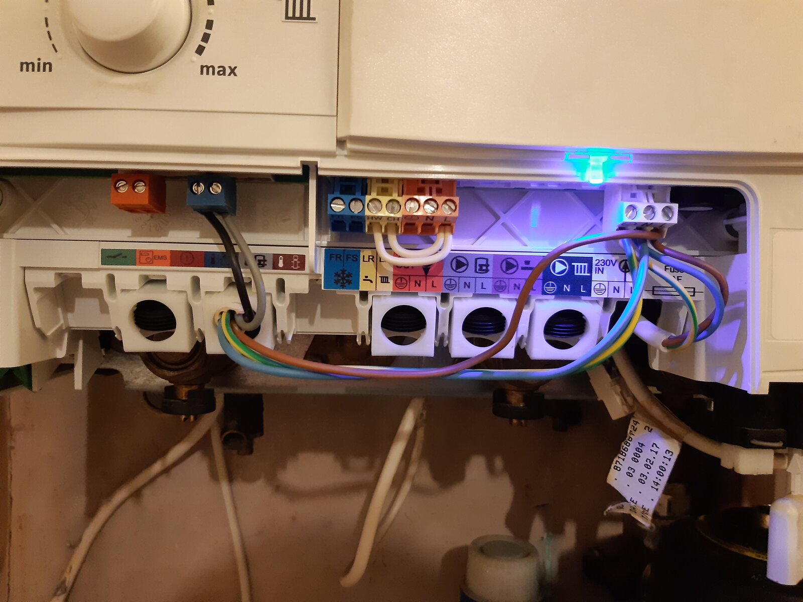

With the cold weather coming along I found out my mother was controlling the house central heating by turning the heating flow control up and down. I asked why she did not use the Honeywell cm927 program controller paired up with a BDR 91 receiver? I put the controller into manual called up a temperature about a couple of degrees above the indicated temp and the BDR green light lit up but the boiler flame light did not come on the display for 4-5 mins, there seems to be this lag or the controller is calling for heat and the boiler does not respond. I revealed this wiring in the boiler there are 2 wires going to the outdoor temp compensator and the BDR power wires are connected to the mains terminals of the boiler, I'm nor sure if this is another way of connecting it, it looks nothing like the examples I have seen on the Worcester Bosch You Tube video about fitting third party controls. Can anyone please help, cannot contact the original plumber. Have included photos of wiring in BDR and boiler. Can anyone please advise?

Not clear what exactly those grey and black wires are connected to in the boiler, but it's wired incorrectly. As it is, the boiler will be on continuously, and has been wasting vast amounts of gas for however long it's been like that.
To fix:
White link between L and CH is removed
black wire to L
grey wire to CH.

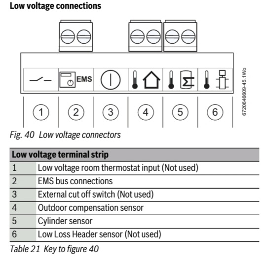

It would be interesting to know how the on/off receiver may be (at least partially) triggering the boiler from those terminals?
The white and black wires were connected to terminal 4 outdoor compensation sensor in the diagram above

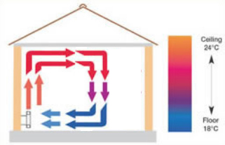

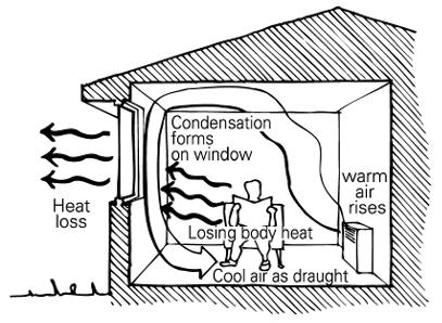

Also air flow within the room, my living room has three TRV's in it, two on radiators, and a broken one on the fire place which still records the temperature, all electronic so I can say at moment the three show 14.2ºC, 16ºC and 21ºC the latter is the broken one on the fire place, but it shows even within the same room how much the temperature can vary. What we hope is the device monitoring the room temperature to control it, is in the natural air flow, diagrams like this circulation3.jpg show expected air flow, so to measure the return air would seem to make sense, so the location of the TRV bottom of radiators slightly off to one side does seem a near ideal location to measure temperature of whole room, the broken TRV on the fire place is really too high and too close to centre of the home.
I do have some things to move the air, two kittens running around the room, but clearly not enough, but each book one reads has a different diagram circulation2.jpgand one has to question do any relate to my home? My thermostat to turn whole boiler on/off is in the hall about centre of the house and in a room where thermals are unlikely to work due to it having stairs in it to upper floor, so wall thermostat shows 17ºC and the TRV shows 14ºC not by any stretch ideal as the wall thermostat turns off heating to whole upper house, the flat under house has its own wall thermostat.
