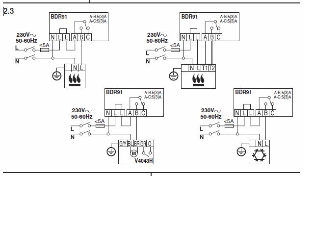

Just try to connect a Honeywell BDR 91 to replace a CMT907A i have only 2 wires 1Live and 1 Neutral
did try this
nothing works, most often the light green led switch on and of directly.
Honeywell says "You haven’t wired the BDR91 correctly on your CM907 the wires were in A and B these have to go into A and B in the BDR91 plus you have to connect a Neutral to N and a Permanent Live to L so in total you will have 4 wires, you need a permanent live and neutral as well otherwise it will not be able to receive a signal from your handheld unit."
can some one please tell me how to connect?

Just Googled BDR91 and Honeywell destructions show as below, So you do need the extra wires. You'll just have to apply the info to your situation as appropriate.
Alternatively www.honeywelluk.com/Documents/Full-Install/pdf/1069.pdf[/QUOTE]
if I Ask here about it its because it is already down with Honeywell uk who tels me to "You haven’t wired the BDR91 correctly on your CM907 the wires were in A and B these have to go into A and B in the BDR91 plus you have to connect a Neutral to N and a Permanent Live to L so in total you will have 4 wires, you need a permanent live and neutral as well otherwise it will not be able to receive a signal from your handheld unit." so i did this

You need to use the flex in A &B.
Add Live and neutral in L and N.
If this doesnt work, you've probably knackered the relay in the BDR by putting a short across it. Incidentally, the dividing partition between the mains volts and volt free contacts is not intended to crush the cabling. Either mount the BDR on a pattress box or cut out the partition, if it is 230v you are switching.

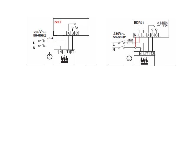

Hi, You are looking to go from a CM907 to a BDR91 so wiring changes as in picture below show what was required. The new wires are the red ones in my picture.
Your photos show red and blue wires and an exposed earth wire but do not identify what they are joined to, so it is impossible for anyone to say what is wrong with your wiring without knowing what is at the other end and what has been done.
The difficulty is that in your first post you showed a diagram for connecting the wires that would have been the same as connecting the live and neutral wires together, you really do not want to do that.
If you really did what your diagram showed, this would possibly have blown the fuse but may simply have damaged the relay contacts ( shown connected to A & B ) in the BDR91.
If you wired it this way It is possible that now your BDR91 is damaged and will not work. If also wired into the boiler it is possible that the boiler may also be damaged.
