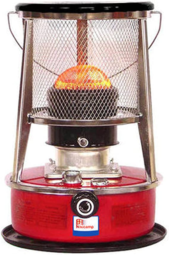

I have been debating buying a small inverter generator and swapping the FCU on boiler to plug and socket, so in a power cut I will still have heating. I do have a small inverter battery pack not sure if large enough for boiler, and a fire place, never lit a fire in it, maybe I should get the chimney swept?
Due to an industrial injury I can't stand cold weather, we have a stand-by oil filled radiator in case boiler fails, but getting out the chainsaw to keep warm is not my idea of fun, and clearly any wood not already cut will be too green to burn.
The one remaining coal mine in Wales the washing plant has failed, so all coal sold direct to steel works. I have seen the problems with compressed coal dust fuel in the boilers at work, the ash, well not really ash, more like un-burnt coal dust gets everywhere, the guards need to sweep the carriages out every run, really don't what that in my house.
So is it one of these 1661835799018.png at the ready? It depends on how likely we are to loose power.
