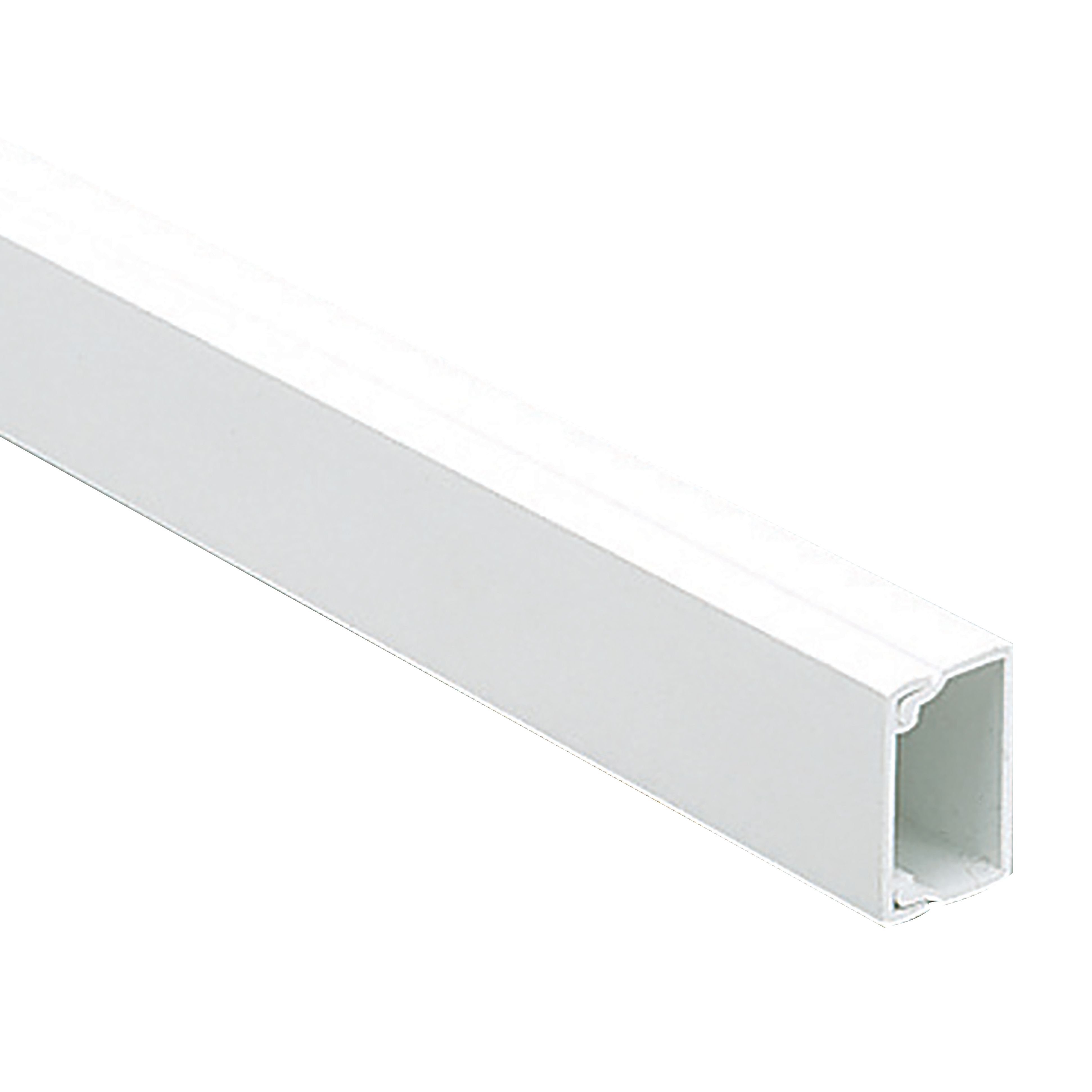

HI everyone,
I'm just redoing my living room that has a couple of spurs running from an electrical socket, and the previous installer didn't chase the cables into the wall, and I'm not judging them, because I can't be bothered to either - they used that awful square box trunking, and it looks terrible, is there a prettier alternative? All suggestions welcome. Preferably something super low profile.

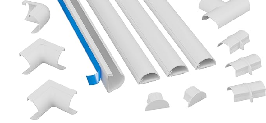

I used D-line 1732616813873.png there is also dado and skirting trunking
but the latter may as well put the standard trunking right above the standard skirting once painted it does not look like trunking just a high skirting.
I found standard T2 trunking was the same thickness as the plaster, so I used a hacksaw blade either side of the existing trunking, removed the trunking, then the plaster under it, and then replaced trunking and plastered up to it, one could not really remove the lid, so more like conduit, but once painted and furniture in place one did not notice it was there. Easier to fix than oval conduit, and square edge easier to plaster up to.
Thanks Notch and Eric for the d-line suggestion, I'll go with that. It's definitely better than the square one.
