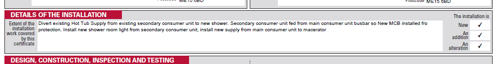

Several years ago I added an electric shower in my daughters house, there was a redundant hot tub circuit on 7/0.044" T&E, the end of which was pulled back and redirected, the person doing the testing and paperwork insisted on describing it as 'reused' rather than 'new'.
Noted, but the installation as a whole is described as new in the right hand box.
Blup
Blup
As there was a new circuit installed (Macerator), the addition is the shower room light (added to the secondary CU, which was dedicated to the Hot tub but now dedicated to new shower room).
I remember the 'which box to tick' discusssion well.
