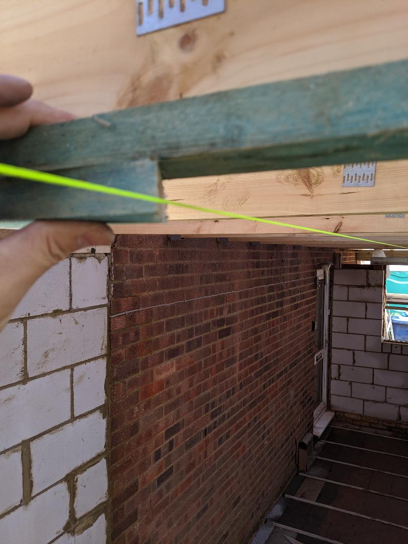

ever seen a ground builder lying fundations with a laser level
I guess he mustve put in a few pegs.....100mm out
Yes, use holding down straps as specified in Bldg Regs part A.I'm not a roofer, but i've always seen wallplates bolted to the wall and embedded in mortar.
Yes to wallstarter - anyway its the easiest way to fix, not sure how else that can done.I cant see any sign of a wall starter being used or vertical dpc. I thought the cavity had to be opened at this point
I suppose the brickie had to cut the first row of blocks inner and outer.Yep, due to his laser level having a fault apparently.
The internal return to a window is only about 150mm in one of the photosNot sure about that return noseall but I think it is greater than 600mm. Will get him to check.
