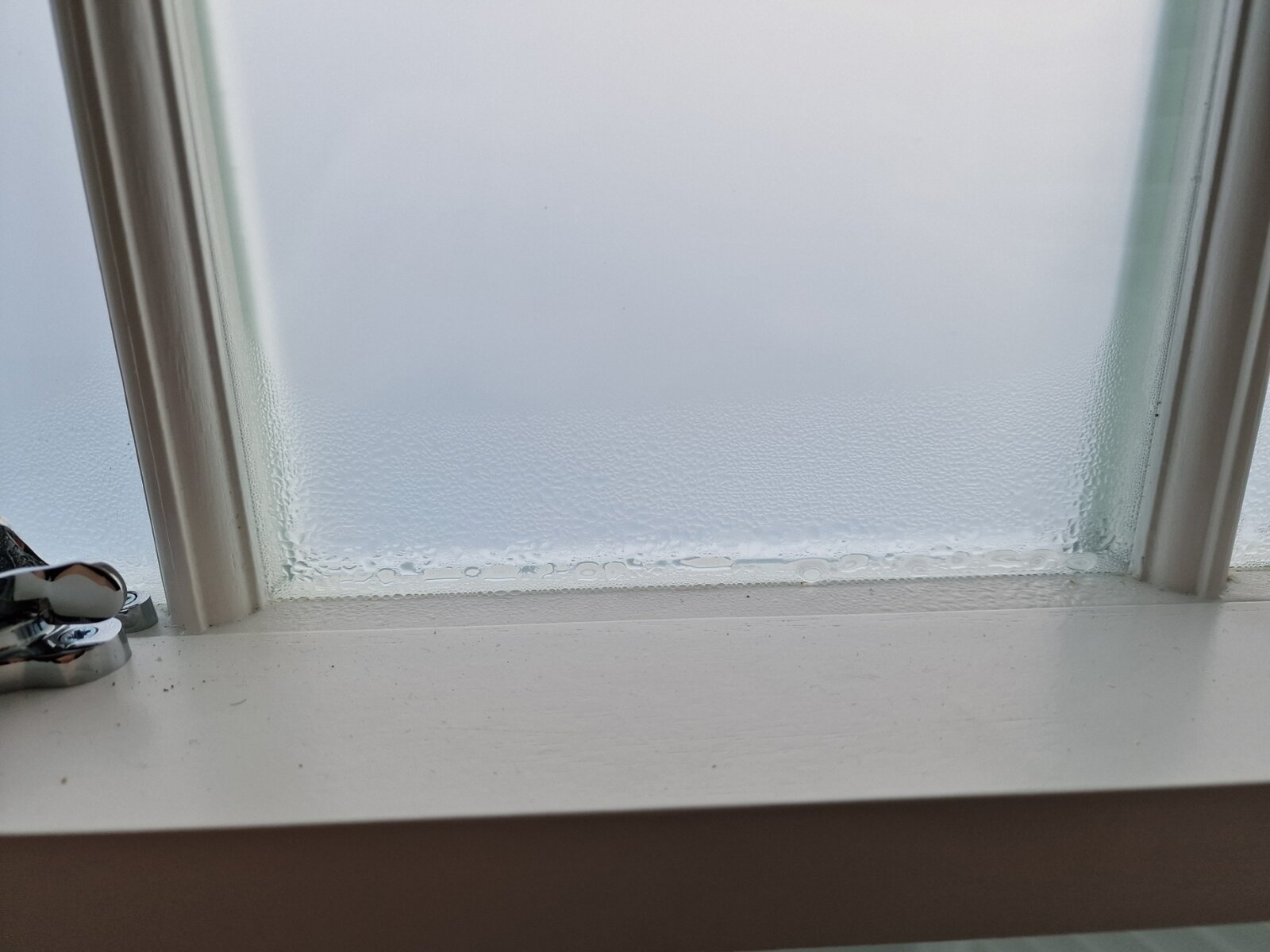

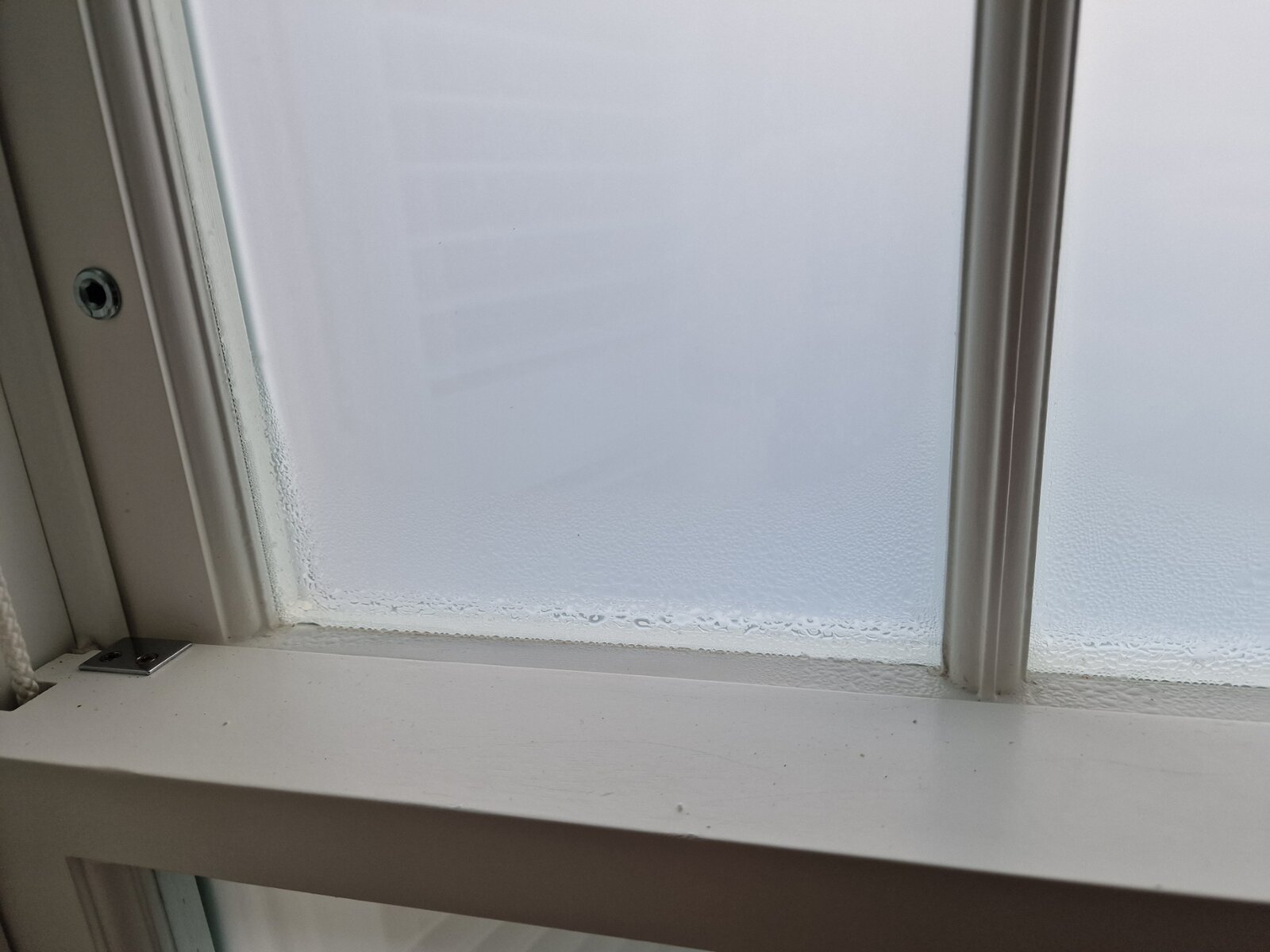

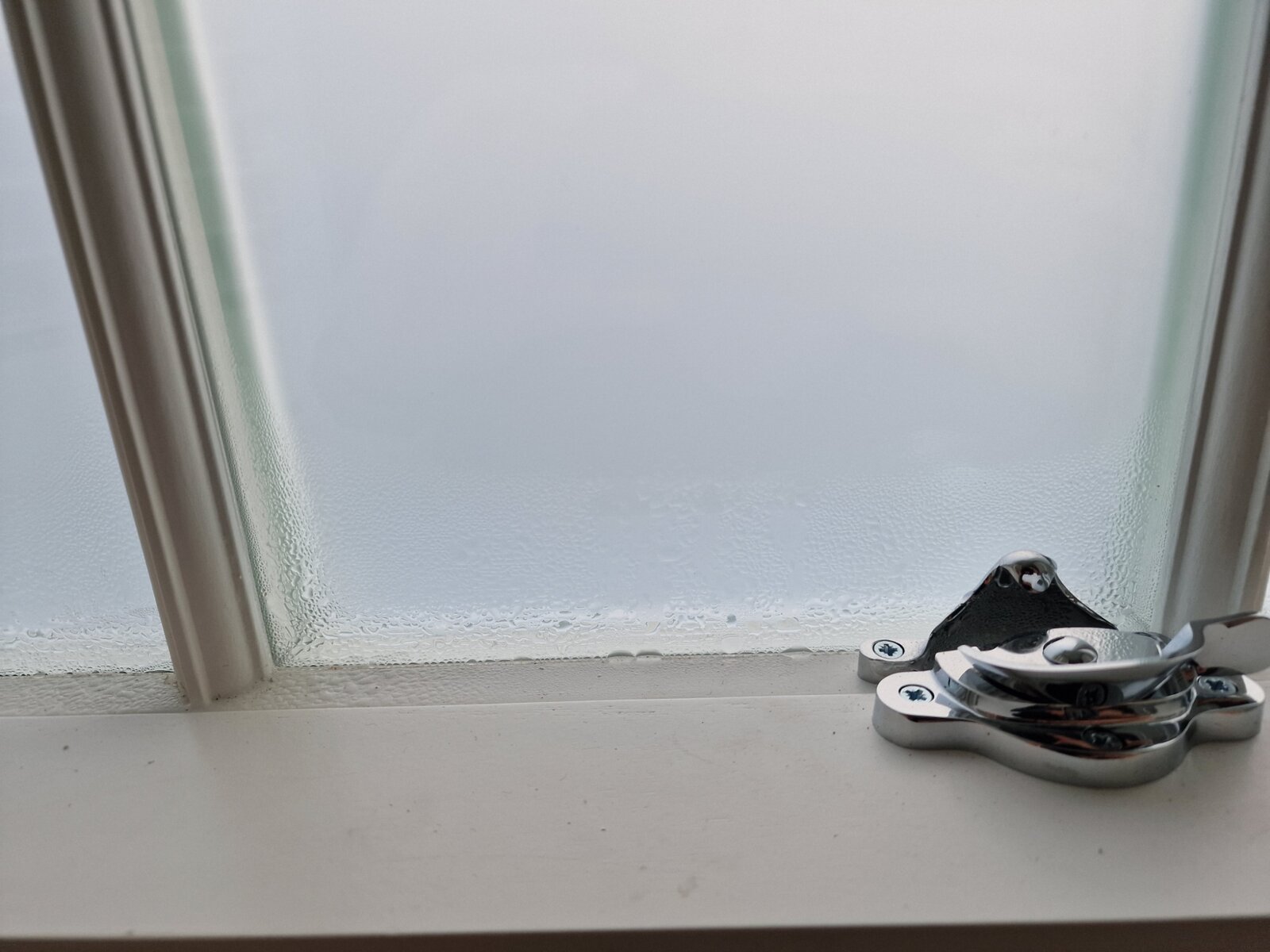

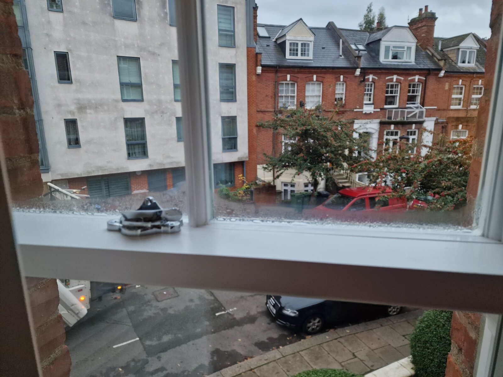

Just had my old single-pane timber sash windows replaced with new, double-glazed ones. I woke up to this amount of condensation, which is much better than the old crappy windows, but still, it can accumulate and build moisture etc.
Is this right at the end of the day for new windows? Should I expect some condensation at all?
Btw, I was sleeping in this room and it has a wooden plantation blind closed, but it's quite a big room, around 20m2 with tall ceilings.

Unfortunately sash windows are not sealed units and you are getting the condensation at the cold bridge line where the two windows join . And as its a bedroom its amazing how much warm moist air we breathe out during 8 hours sleep.
You can improve the cold gap between the two windows by retrofitting an insulated plastic bar to the underside of the top window to close the gap when the two windows are together and vent the moist air of the bedroom to the the outside by adding trickle vents to the top of the fixed window.

It doesn't really matter what they mean, you need to increase ventilation to the room in some way or live with the condensation. A trickle vent can be a convenient solution, instead some people keep windows ajar over night on their night latch though you don't have that option with a sash. It may seem ilogical but uness you stop breathing there isn't any other way. There will always be a compromise between achieving the desired air tightness and adequate ventilation.

The weird part is that the condensation is only at the part where the sash windows meet. Also, I've been to places with aluminium windows or plastic sash windows and that doesn't happen. Hence my original question.
Condensation in houses is a fickle beast and can be very difficult to predict how and where it may occur.
at a guess the glass temperature is likely to be at least 10 degrees cooler than ambient room temperature
its concentrated near the meeting rail which is a bit of a thermal bridge
with shutters, the window reveal is still open to vapour from the room but the shutter is closing off the rooms heat to the reveal and so the air cools down in the space.....
