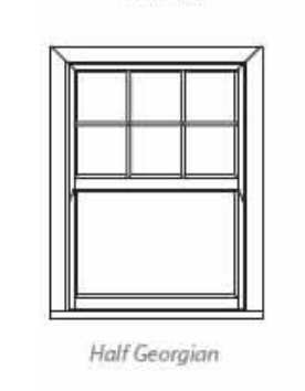

I want to install double glazing to my single glazed timber sash and case windows.
I realize that is possible to do this by simply adding a new sash with a double glazed unit, however my question is:
Is it possible to install double glazed units of glass in between the existing muntins?
My style of window is a half georgian (see attached example).
I realize that for the bottom sash i could take out the existing single glazing, router out the channel around the sash to allow a thicker double glazed unit to fit in (as long as the thickness of the sash allow this).
However, what about for the top sash? Do i have individual double glazed units made to fit in between each muntin and router out around each muntin? Or do i remove the muntins and fit a double glazed unit to the sash and then add new muntins on top?

The short answer is: yes you can
You need slimline units, typically 4-4-4 i.e. 12mm thick overall with a spec of soft coat low e and krypton gas fill. It needs special small margin of about 7mm
The glass is bedded on a small bead of low modulus silicone, then once set a bead is run around the outside to fill the gap between glass and rebate. You can't use linseed face putty it needs an acrylic putty like dry seal MP.
You will need to change the original weights for lead and rebate the sashes to accommodate the increase in glass thickness - which is possible as there will be a flat of 13mm or 16mm before the moulding.
Reddiseals sell lead weights.
Be aware slimline units are £25 each for those small Georgian panes

Krypton lowers u value, it can get you down to buildings compliant u values but if you aren't bothered that's a money saver, just use argon
Here's the issue......double glazing technology is designed for drained and vented application, i.e. A 5mm gap all around allows water getting in to run down to the bottom rebate and drain out through holes.
Slimline units have to be fitted as fully encapsulated - i.e. no gaps. S the small gap must be filled with low mod silicone and then face puttied. Traditional face putty shrinks and cracks, moisture will get in.
The acrylic putty sets a bit like hardish silicone, it has much higher adhesion to the glass and timber than putty.
The other issue with slimline is that despite what you may read on the makers sites, it's nothing magic, it's simply a double glazed unit with the spacer bar set close to the edge than normal to create a small margin and then sealed with normal hot melt, but the gluing area is narrower, from say 9mm down to 3mm - making it more vulnerable to premature misting up. That said if it's done as per above and quality units are used, you will get a fair number of years before the units break down.

Yes there are 2 pack polyurethanes, special silicones, polysulfide options. I don't know if they are used much.....I believe it's the cure time that is the reason they aren't used, but I don't know. certainly almost the whole industry in UK uses hot melt for standard DG units.
Hot melt doesn't crack the seal to the glass fails allowing moisture in. In drained and vented systems it's often caused by unit sitting without shim down on rebate and drain holes blocked so unit sits in water.
