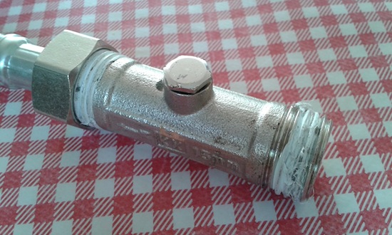

Hiya,
I bought a garden tap kit from toolstaiton, and it comes with this (pic below).
So, does any one knows what the purpose of this looks like isolation valve for?
Or it's not an isolation? Could i just by pass it?
Thanks!
You cannot by law by pass this it's to protect against back flow and not let polluted water into the mains potable supply,if the water supplier catch you without one you get busted big time.Bob
